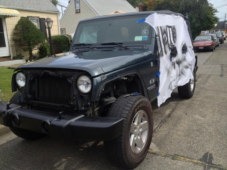

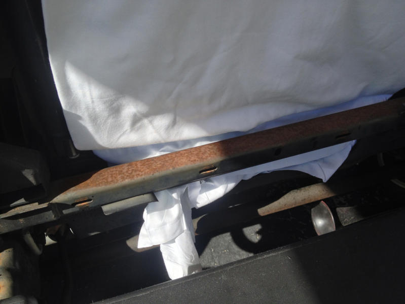

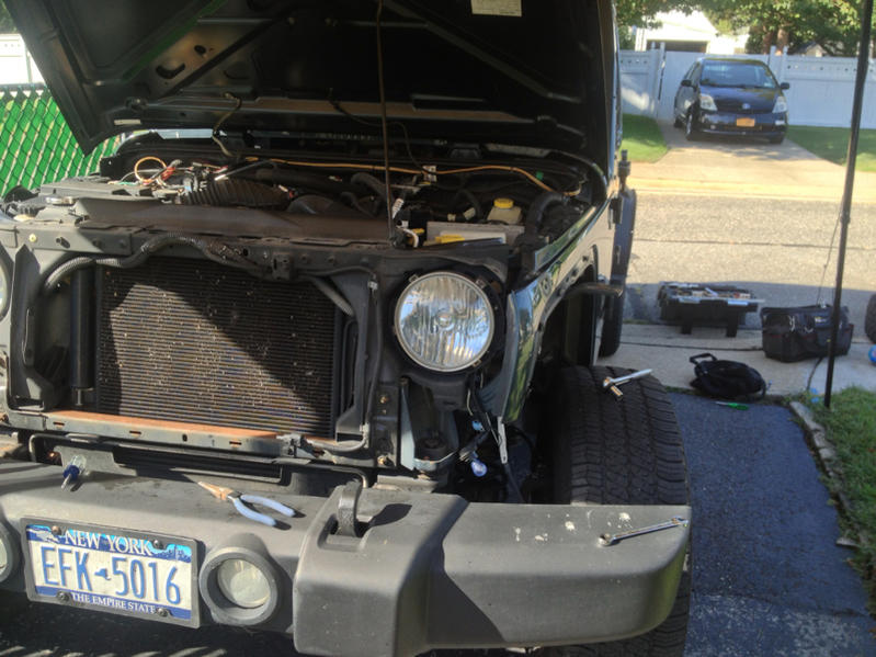

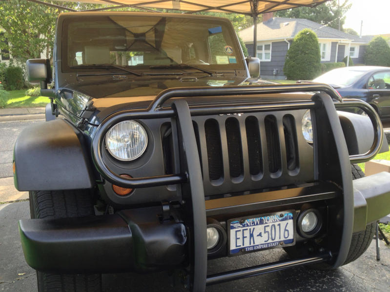

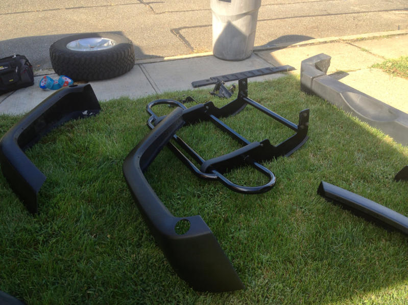

It's not a product, but I uses Krylon Fusion Satin Black. The problem is you need to either mask off the entire car or pull the fenders to do it. I just did my fenders over the past 2 days. I could have done it all in one day but I worked slow and took my time.
The photos are from today. You can see all the fenders off, I also pulled the mirrors, rear bumper, tail lights, and side steps. The door handles were left on the jeep and I used hospital sheets to cover the jeep. I a lot holes over the handles and then used take to fill in the space behind the handle and close the slit around the handle.
I've used the krylon in the past and it lasted over a year without noticeable fade. I finished after dark because I also installed the push bar pictured but will post day time photos of the finished job tomorrow.
Walmart had them for $4.65 a can and total I uses 4 cans.
