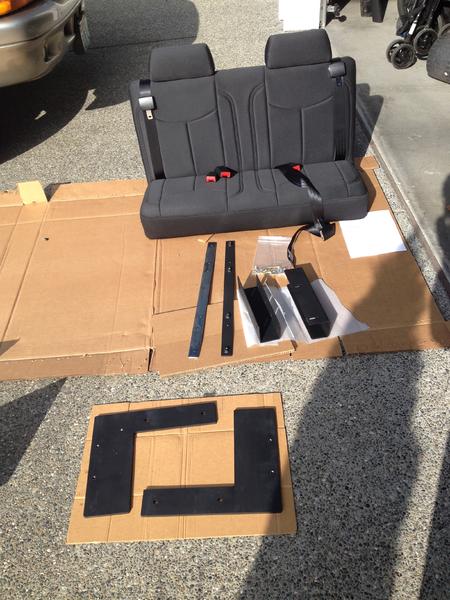

We ordered the Little Passenger Seat Deluxe seat with head rests and shoulder strap seat belts in black fabric to match the existing. We wanted to capability of being able to haul more than just five of us and we decided this was the best solution for us. The seats will not be used regularly, but the need is often enough to warrant it for us.
It came packaged very well and after unboxing and laying out all the parts:

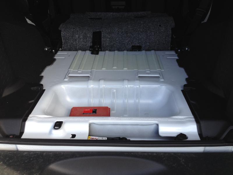

You start by taking up the carpet in the rear. I pulled the tray out as well for ease of cleanup later:

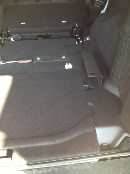

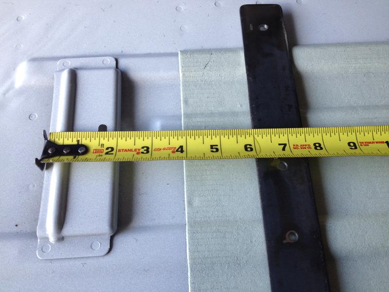

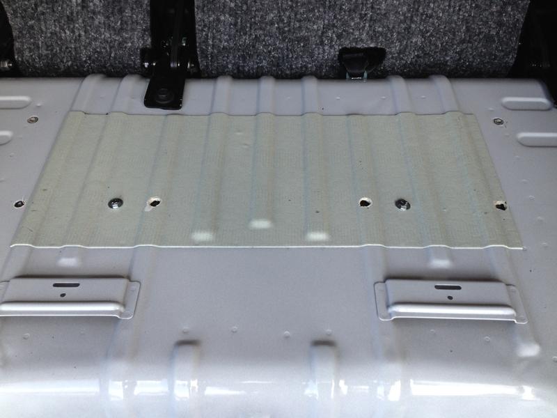

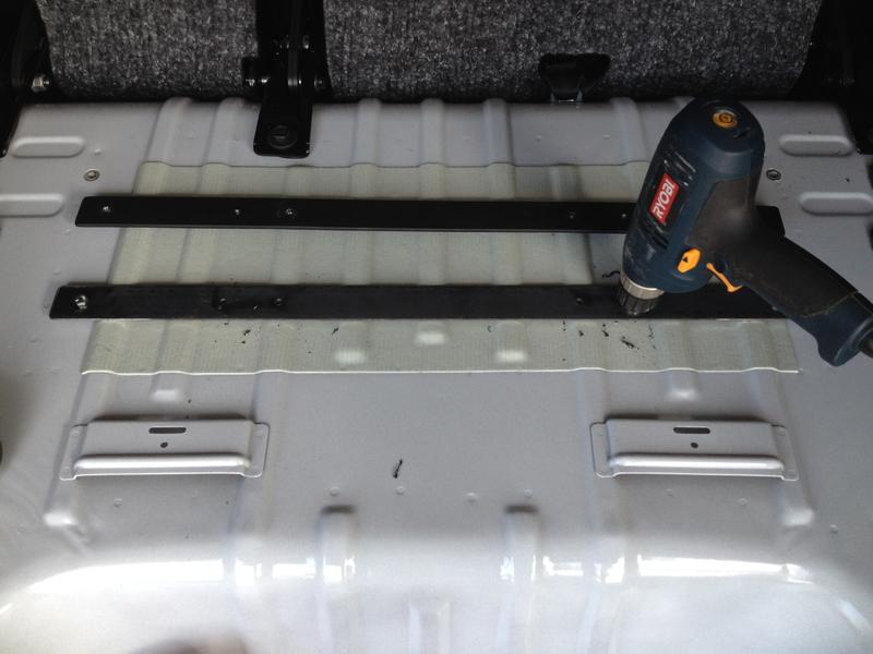

They give you a 1/8" thick steel bar template in which to use to drill your holes perfectly. In my 2014, it was to be placed 6" back from rear edge of the cubby cover brackets. I drilled the drivers side one first after very careful measurement and inserted a small bolt temporarily to hold it in place. Then the passengers side one. Then drilled out the remaining four holes:
I place the underbody bracket under the rear tub and had my son place the small bolts to hold in place.

Under body mounting bracket bolts in place and the main holes drilled up to 1/2"

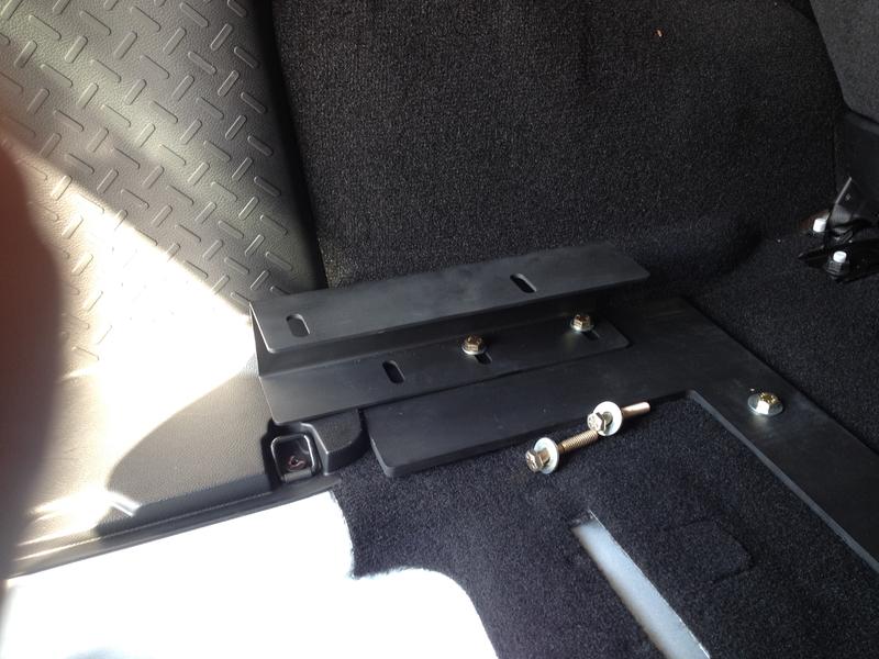

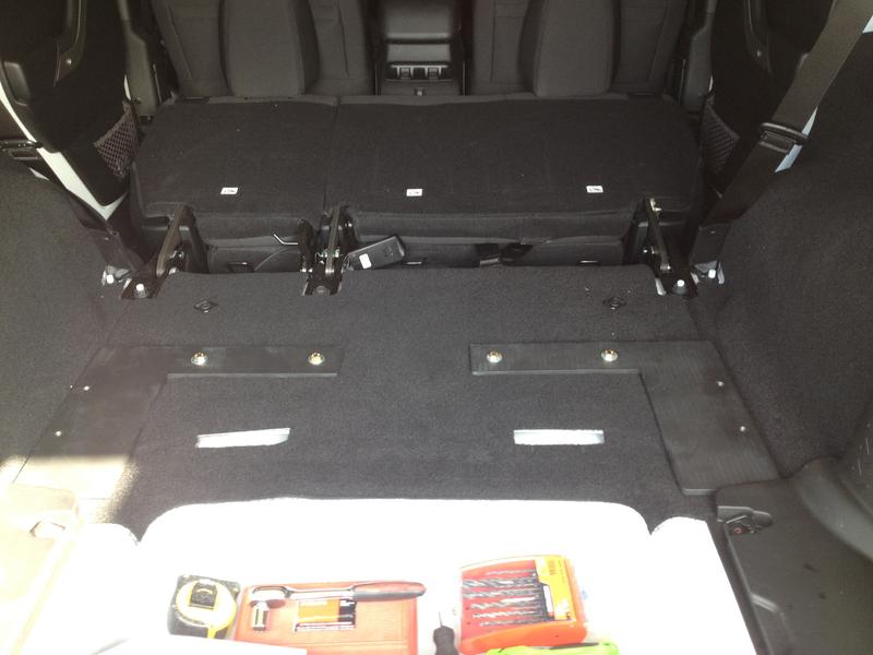

Put the carpet back down after cutting slits in it for the bolts to pass through. Then bolt the mounting plates in with the graded bolts.

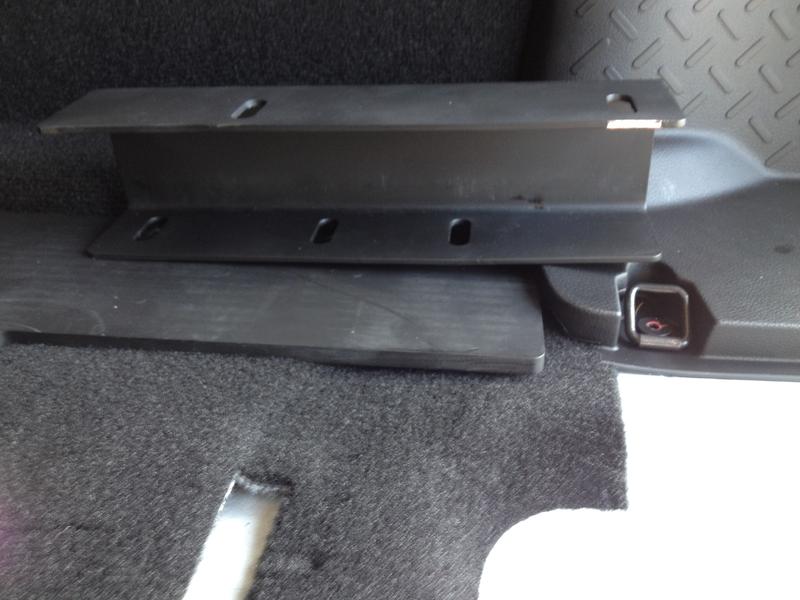

There is a slight fitment issue with the seat attachment channels and the plastic covers in the rear sides:
Nothing a dremel couldn't handle, trimming the plastic a bit. After tightening down the bolts it was pretty flush:

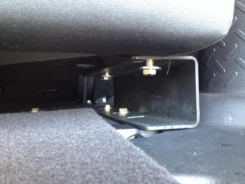

Getting to the main bolts to secure the seats is a bit tight but I could get both hands under to tighten everything.

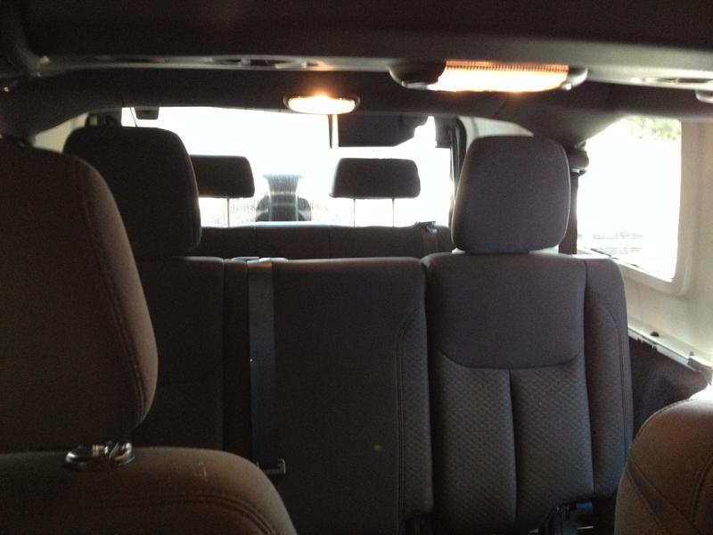

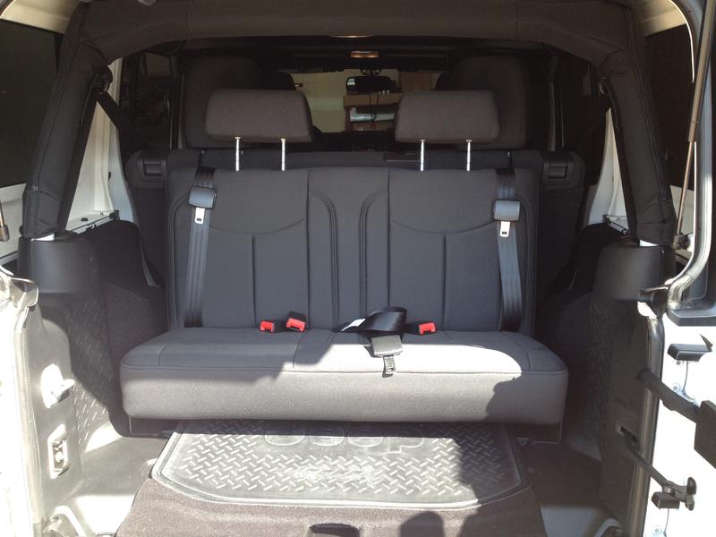

Here is the seat installed facing rearward. My kids were about at the maximum size you can fit back there as the legroom is not much. The cloth color and style matched almost exactly to the factory cloth.

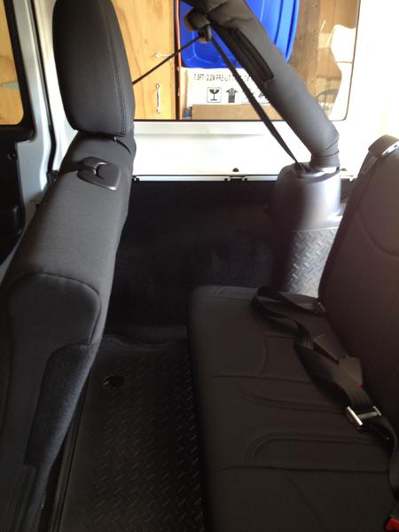

We turned it around (about 10 min to do) to face forward to give it a try.
Much more legroom for the munchkins. My wife even got herself back there.

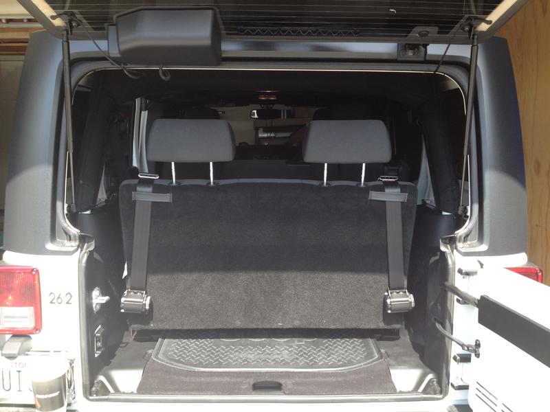

And here you have it. An eight seat wrangler.

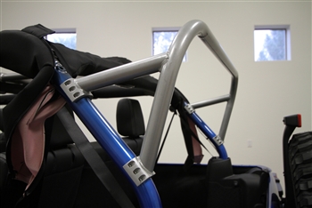

I am going to buy the single seat for my 2012 JKU soon. I have read a lot of negative reviews on the lack of a rollcage protection for the third row seat and decided to make the seat rear facing. I also came across this rollcage extension made specifically for this issue. Rock Hard 4x4 3RD Row / Accessory Mount Sport Cage for Jeep Wrangler JK 4DR 2007 - 2015 [RH-1032] It supposedly fits with the squared soft and hard tops and can be installed without removing them according to the video.
Just seems like a good option if you decide that you need more of a cage around the seat.
Also thanks for the post and pictures. It is really interesting to see that there is more leg room forward facing then rearward.
