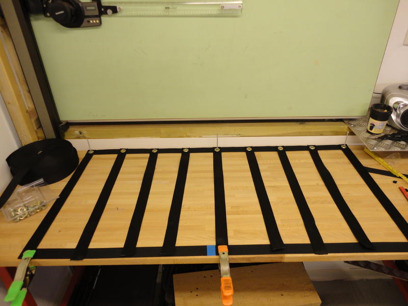

Make your own cargo netting for a fraction of the price.
I got 100 yrds of strapping for $26 and around $25 for grommets and a punch. With a day or 2 of your time and you have saved money for them more important parts
ID:	117281Click image for larger version
ID:	117280Click image for larger version
I'll be going for the complete set up like on this
I'll post more pics as I progress

The strapping is 1.5" 100 Yards Lite Weight Black Polypro Webbing and that was purchased from countrybrookdesign.com. The grommets and punch you can purchase at most hardware stores. BTW I have about 1 hr off work into what you see. After i get all straps fastened to out side, I'll have the wife break out the sewing machine and sew all intersecting straps before I punch hole and mount grommets.

Seattlefabrics.com has some nice heavy duty nylon webbing in stock and grommet kits. I was up there a few days ago picking up some boat glass for a project.
Tandy Leather carries the black anodized brass military grommets if your want a stealthy look.
I'd reccomend burning the holes for your size "0" grommets with a soldering iron so they don't frey out and pull through when the monkeys start climbing your Jeep.

thanks for the advise any and all suggestions are welcomed! this is my first time with making ones of these , so come with ideas people.
