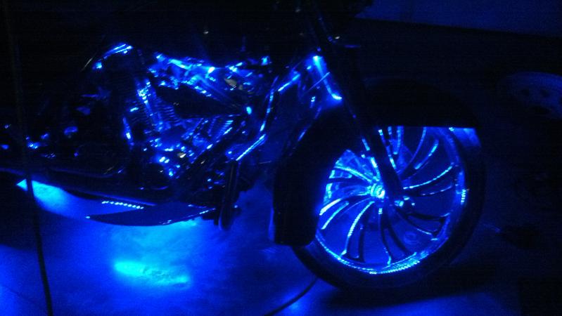

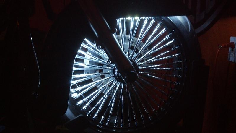

I'll try and shoot a video or take pictures next time I do a set of lights to help you all out.
