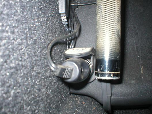

here an easy one. Take the speaker out of the sub add a 12 volt power out let run wires to a a relay one side to the lighter and the other to the battery.
Ok why now you have a outlet for portable compessors, coolers, chargeable flash lights Just about anything you don't want in the front seat.
Yes reinstall the speaker it was only removed to keep from drilling.
Parts list 12 volt out for pick up trucks beds, relay
toatl cost $25

Default photo of 12 volt outlet
Originally Posted by Grant211
got any pics?
sorry but I don't have any of the actual process just the results. Here goes
Name:	12 volt outlet.jpg
hope this give you the idea behind it. No change to the sound of the sub.
