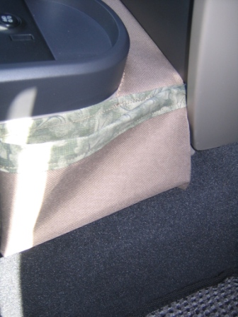

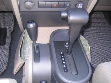

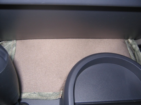

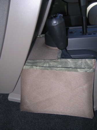

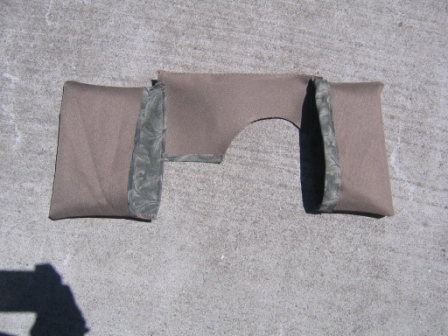

I needed more space to throw all my crap so I came up with an idea to make saddle bags for that dead space on the console. I just test drove it with the top off and it stays secure. I used a couple of those 3M stickys underneath just to be sure.
I just took computer paper and layed it on the console to make the pattern. Just cut and trim until the paper fits, do the same for the side bags. Add a seam allowance when cutting the fabric and sew.
