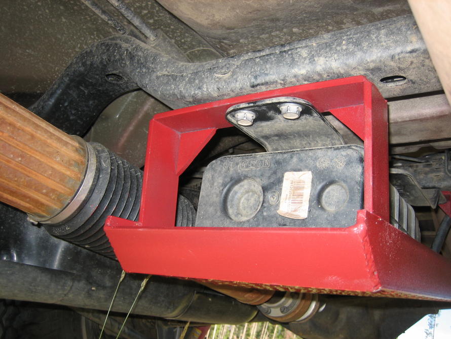

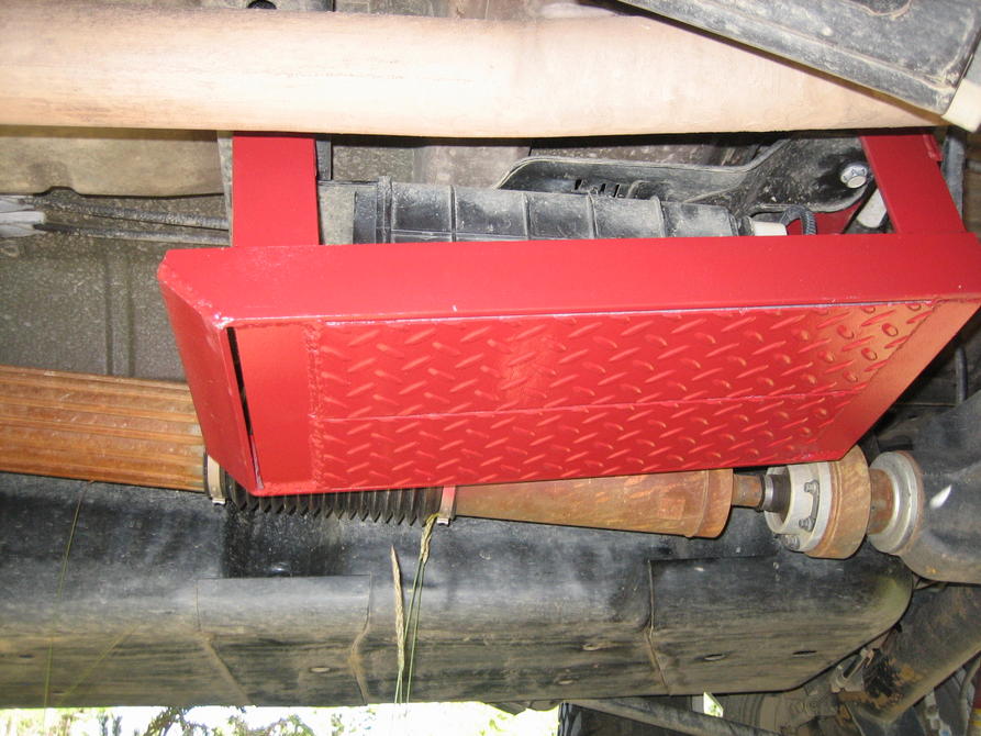

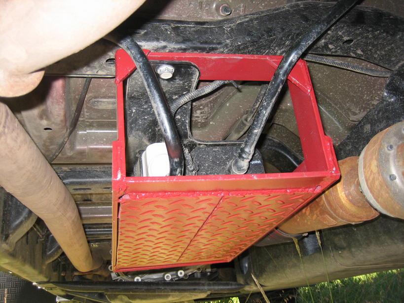

four hours of fabricating, less than 50$. I used 1/4" x 2" bar stock and 3/16" diamond plate. I was under the Jeep yesterday and saw that a chip of plastic rib had already been broken off of the evap box so I figured that some protection was in order.

here they are
