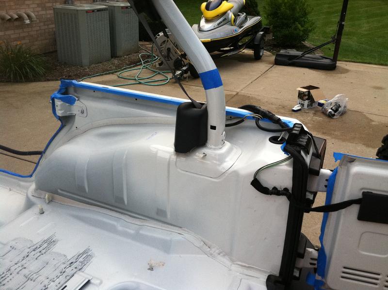

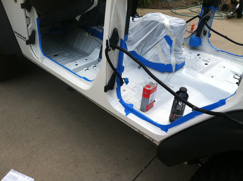

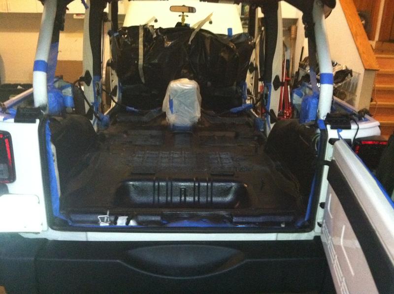

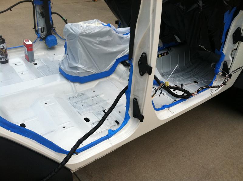

I didn't sand mine down or anything. I tore everything out and washed the tub thats it. Didn't even remove the sound dampening material. Its hard as a rock so I wouldn't even bother sanding it. I made sure to mask everything off completely. covering dash and everything with garbage bags. I still ended up getting particles on the hood... you can't see them but you can feel the texture. Click image for larger version
