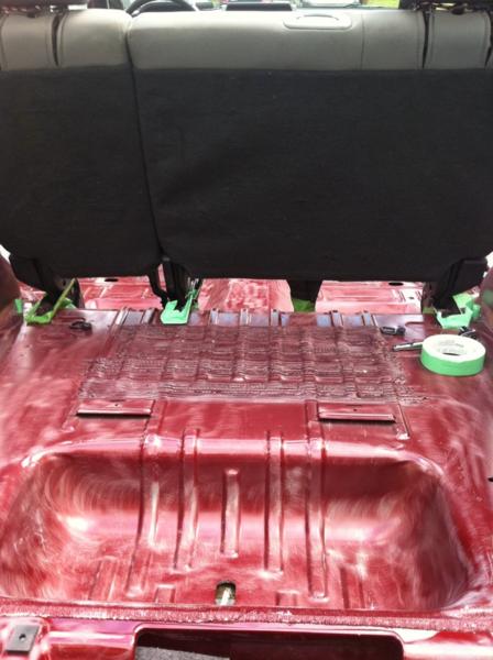

I just lined my tub yesterday with ez line from Canadian tire (for all u Canadians on here).
We took out seats. Did some taping. Only folded up back seat since the bolts were a pain in the ass.
Did a light sanding with a wire brush on a drill. Taped it up. And use brushes to dab on first coat. And did second coat next day. Came out really well. Still drying though because we had a cold snap.
Here are some pics.
And by the way. This shit does not come off your hands. All three of us look great!

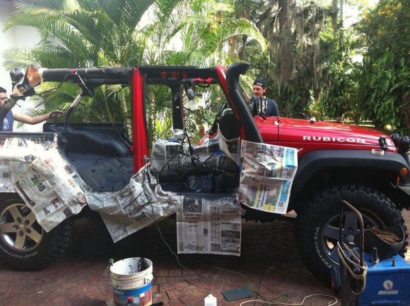

Did mine yesterday took me all weekend to take out seats and that sound dampening is a pain, thx for the write up very helpful
