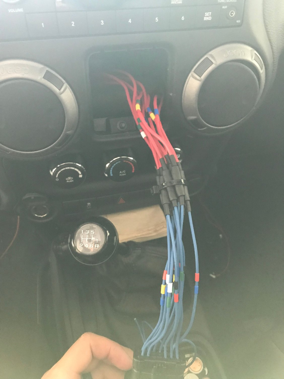

Basically my current situation is, I bought a 2016 Wrangler with the half soft doors. We ended up trading doors with a guy that had factory power everything so currently we have power locks and windows that do not work. I ended up changing the wiring harness in the doors so they would fit with my factory 2016 body harness. But because they did not have power windows before I obviously do not have switches.
My research and conversations lead me to believe basically I need to buy the factory switches and pull power from somewhere. Once I do that I should be able to finish wiring the switches to the female body harness. By following the wiring diagram I should be able to find the vacant window ports on the harness connector.
Does that make sense? From your experience do you think this will work?
Old Jul 9, 2018 | 03:48 PM
  #44
Norman Hopkins's Avatar
Joined: Jun 2018
Posts: 3
From: JB MDL, NJ
Talking Everything Factory.

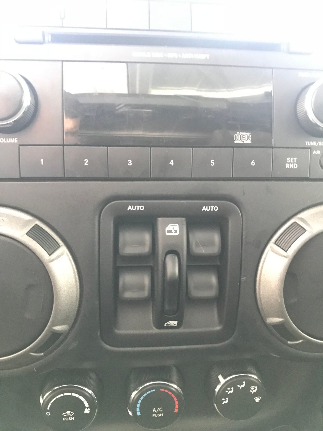

Okay so I've been successful by wiring everything from the factory switch with the proper harness coming out of the back of the switches! You can see from my photo my JK looks very different from when I bought it (top) to now (bottom). The main difference is we found someone who wanted the half soft doors and we traded them for their full steel automatic doors. The issue I ran into is the doors were off of a 2014 JK and mine is a 2016, in 2015 they switched the harness styles so the quick detach harnesses didn't match. So this was the first issue I addressed. I bought the factory harnesses from MOPAR that fit automatic windows/locks for a 2016 and switched out the harnesses.

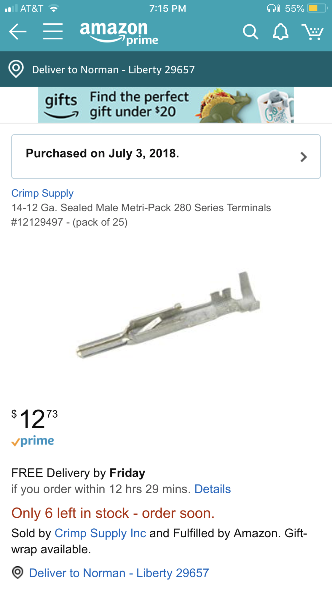

After Jeep told me what I wanted to do was impossible I took it to a local Jeep shop and they said its possible for $500-$600, and this would only give me the forward window controls. So a buddy and I decided to have a go with the help of the original thread we were able to accomplish it. I went cheap and bought 100 feet of wire and color coded it using electrical tape. The main difference is I tapped into the back of the factory harness like I said. for that you will need the "14-12 Ga. Sealed Male Metri-Pack." This will allow the quick disconnects to talk to each other.
Hope this helps! Let me know if you have any questions.
