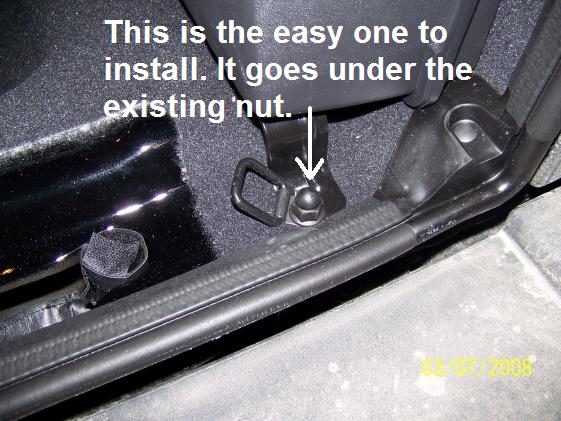

The Mopar part number for the Jeep tie downs is 55361485AA. The dealer got 4 of them for me @ $2.50 each. There are holes with rubber plugs at each corner of the cargo bay in my JK Unlimited Rubicon. The aft right one is occupied by the sub-woofer aft mount bolt. The tie down goes under that nut.
I am working on getting the part number for the riv-nuts for the other 3 tie downs.
The dealer parts guy said Chrysler dropped the tie downs in the Wrangler for liability reasons. Chrysler resisted letting the parts guy order them, but ended up allowing it. If he cannot get the proper riv-nuts and bolts, I will use commercially available parts.

See the attached pictures for details of tie down installation. These are all the parts which should have been installed in the Wrangler at the factory. The parts guy said Chrysler Engineers told him they were left out for liability reasons. He could not explain why all the other Jeep models have tie downs.
I pulled the rivnuts with an all-thread bolt, washer under the head, and a long piece of thin steel under the washer to help keep the rivnut from spinning. The rivnut is hexagonal, in a hexagonal hole, but I wanted to make sure it would not spin during installation.
