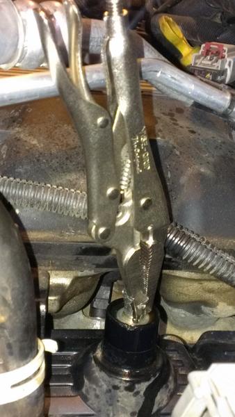

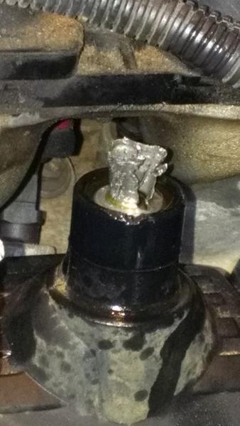

Someone please help. I've tried to remove my PCV valve with vice grips and can not get this thing out. I've mangled the valve and am running out of patience. How can I get this thing out?

Now I have put P B blaster around the valve and even bent 3 small screwdrivers trying to leverage the valve out still no luck

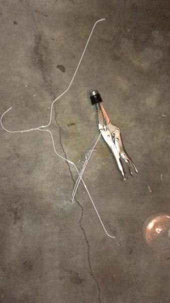

Had to get creative but I finally got this damn PCV valve out. Used a piece of a wire coat hanger to hook up the needle nose vise grips to a ratchet strap over head in order to finally get it out! Then slapped some PB blaster on the new PCV valve that I got from O'Reilly's put a 15 millimeter long socket over the new valve to protect it and it went right in! Whew this has turned into quite the night

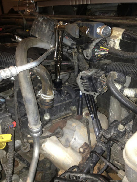

Just did mine last night thanks to this thread. (Along with the plugs and wires) like others I had zap strap failure so this is what I came up with....
Its needle nose vice grips attached to pcv then regular vice grips attached to then needle nose at a right angle. I just tapped the top vice grips from underneath with a deadblow hammer and she popped right out.
Cheers and thanks for the writeup

I did the exact same thing with the vice grips! Was really easy that way, after I cussed the zip ties that kept breaking!
