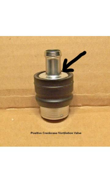

So installed mine today, brute strength n zip ties and no luck. Mangled the hell out of it. This is just a pic i downladed, where the arrow is , there is a small hole. I made the whole bigger and jammed needle nose pliers in it. Cranked it with leverage and popped right off. New one from oreillys popped right in. Seems smoother on the idle. Old one was rattling but looked gummed up.
