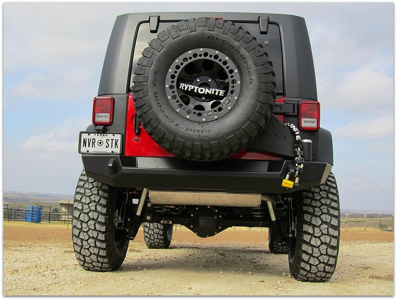

Old Nov 21, 2006 | 07:29 PM
JKwannabe's Avatar
Joined: Oct 2006
Posts: 70
From: Ohio/Kentucky
Originally Posted by BeerMonkey
so where does the muffler go? im guessing not in the rear anymore
you can see it in the pics he included in his post, it is right beside the emissions canister
