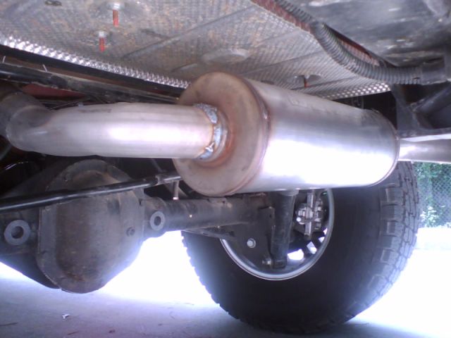

put a 6" round by 18" magnaflow were the factory muffler went, sounds great and I can tell the differance in power, now working on my intake today. cost 120.00 installed including muffler
DO YOU HAVE A MODEL NUMER???
Old Jun 1, 2007 | 09:43 AM
  #102
plugman's Avatar
Joined: Feb 2007
Posts: 36
From: Tomball, Texas
Default muffler
the sound bites that everyone has been posting sounds about right, I dont have a way of recording the sounds myself. The sound is noticable but it isnt bad at all. Driving to the fire station this morning, out on the highway, it really seemed to have more passing power and pickup, the sound wasnt really that much more at 70 mph than normal. I run 33's on 2.5 lift, six speed, 4-door soft top.
the model number was #12646---that is 2.5 inch inlet and outlet, 6 inch diam. and 18 inch muffler length, overall 24 inch.
http://www.magnaflow.com/02product/s...ne=main&id=513
I hope that link works,
I will post pics of the muffler sat morning once I get off from the station, if I didnt answer the questions clearly enough please ask.

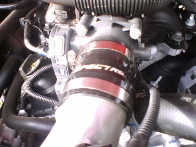

I finished my intake yesterday, and it is great, I have all the pics but I havent figured out how to shrink them to posting size. but I have the parts list:
1 k&n airfilter part # re-0910 from o-riellys 45.00
1 spectre vacuum/ sensor adapter kit part # 8711- its at autozone in the
import section. 6.99
1 spectre intake couple 21\2 to 3 inch part # 8751 "same location"
a 60 to 65 degree angle piece of 3 inch muffler pipe, about 2 1\2ft piece. You will need to cut down alittle.
I used a little plastic tote, cut down to size, Maybe be dumb to some, but it works prefect, and if your budget minded, it works great untill I can get to a machine shop. 5.00
I bought a 5\8 steel round stock for the valve cover hose,welded a 11\2 piece on, but now looking at the 8711 kit it has the grommets and adapters to get the job done. you will need a better drill bit the one supplied, stinks on this pipe.
Tighten everything up and go wheelin, I was impressed with the preformance and cost around 230.00 for everything muffler too.
If you are in houston and want to come to the north side I'll even help,
I'll send pics via email or if I can shrink them, I'll post them,

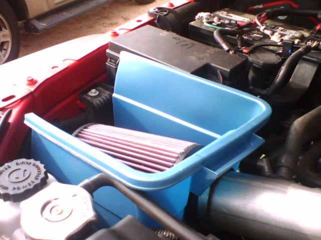

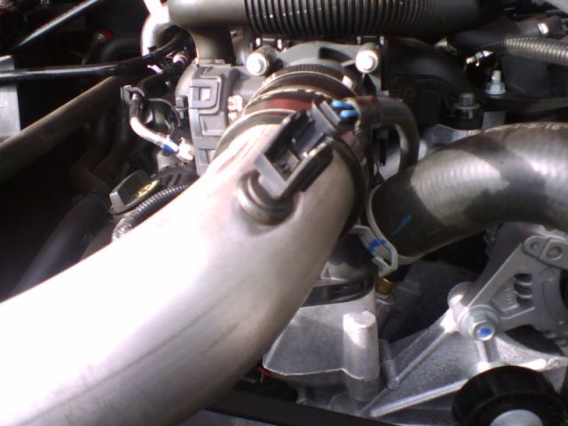

some pics, the air box is primative but I wanted to try it out and it gave me a good idea on the size to build my box.
Name:	intake adapter.jpg
ID:	1962   Click image for larger version
Name:	o2 sensor.jpg
ID:	1963   Click image for larger version

And yes to ya'll that notice, I did break that lock on the sensor. heres the redneck airbox that didnt load last set. It worked really well on my measurements so.....
