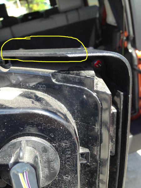

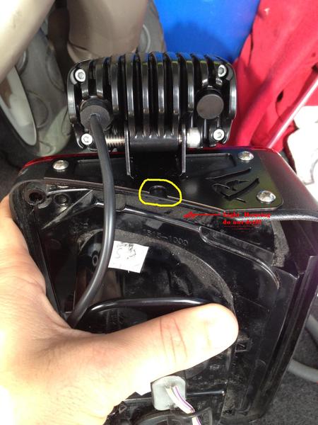

Did you use silicone or anything to seal the drilled/filed hole that the wire feeds down into to keep water from getting into it?
Old Feb 14, 2013 | 04:16 AM
  #23
Gilbemods's Avatar
Posts: 95
From: United States
Into the brake light or into the jeep body?
Into the brake housing, no because it doesn't matter if water gets into the housing because the trim you drill into is just a trim around the light. It doesn't penetrate the brake light.
I used the factory wiring grommet to run the wiring.

I have a pair of the srm diffused and the rigid brake light mount kit too, I haven't installed it yet, this weekend perhaps, but I was thinking maybe a little silicone to plug the entry hole. If I remember correctly (when installing trailer wiring harness) the electrical connectors to the tail lights are exposed with the only seal being how flush and tight the light housings fit to the body. I figure if you drill to allow for the wire it will also allow for moisture, rain, etc. to get in too?
Old Feb 14, 2013 | 05:58 AM
  #27
Gilbemods's Avatar
Posts: 95
From: United States
if you take off the light, you will notice it has a thin outter plastic shell that holds the light housing inside, separate from the outter shell
heres a picture with what i am talking about, the yellow is what you notch out.

the red is the actual light housing you DONT drill
