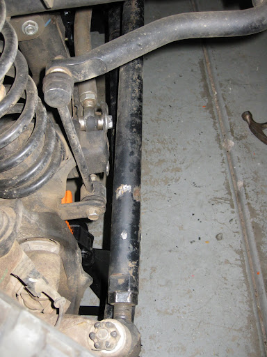

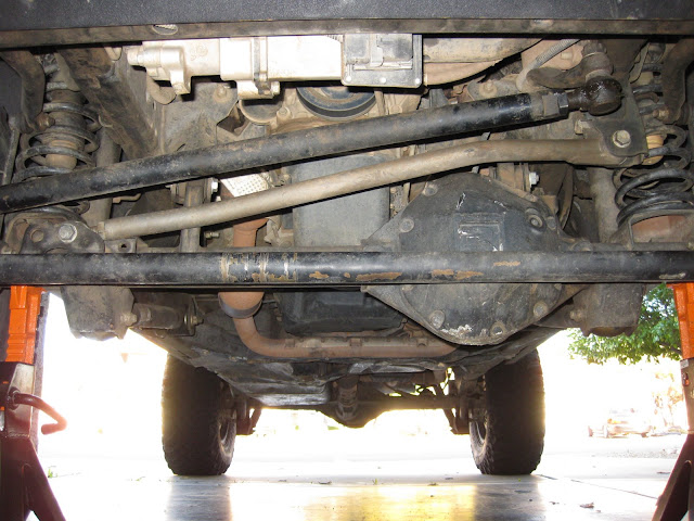

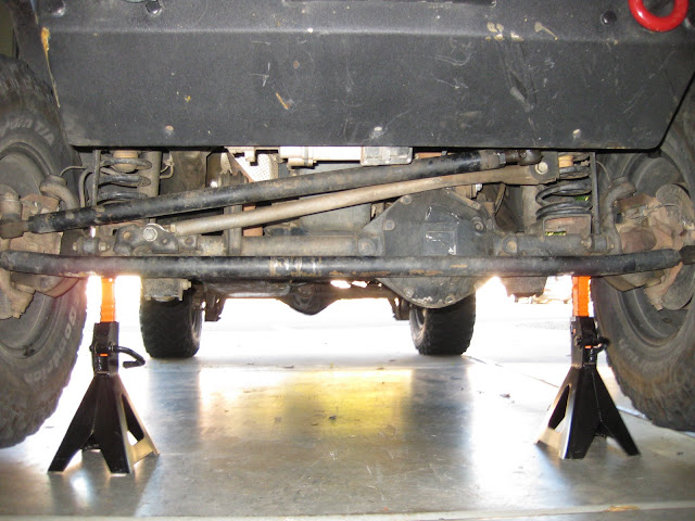

Well... I have the Rock Krawler Drag Link and Tie Rod, and there is just NO room to rotate the steering stabilizer on top of the Tie Rod since their diameters are much larger. My Woods SS relo bracket wont fit... Here is the RK setup:
Beefy rods!

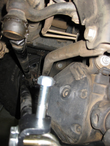

Here is the rods compressed against each other, and the SS/DL bracket when the wheels are turned full lock to the psgr side. Not much room!

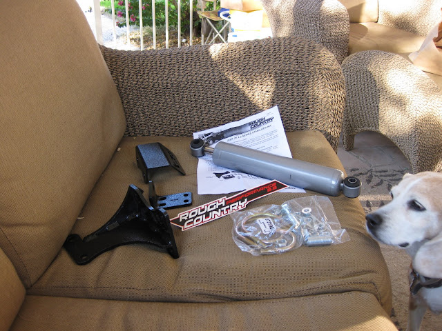

They sell the kit for a single SS off of the drivers side, and it is upgradeable to the double too. Bought it immediately and it showed up yesterday.
My beagle even thinks its cool!

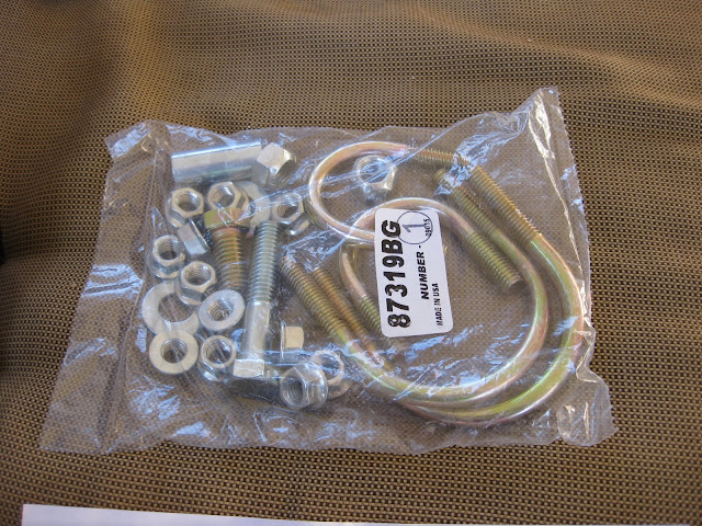

So I do a quick parts list check and realize that I am missing a 1/2 x 2 1/2 bolt and nut... and have 4 extra of the 3/8" flanged nuts.
Anyway, I have some 1/2" bolts in the garage and can make due...

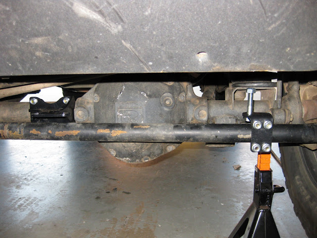

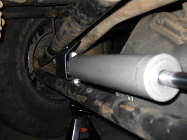

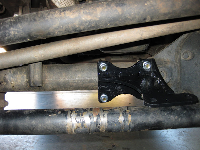

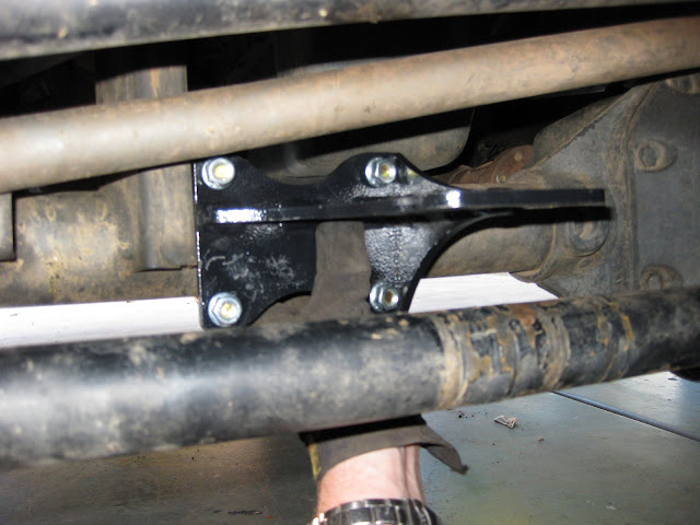

So, I have the rig on jack stands under the axle, so the wheels can be turned both directions when need be. I start to mock up the axle bracket, and wonder if its going to work with the beefiness of the RK rods. It is supposed to mount next to the upper control arm bracket like this...
I decide its just too tight on that side when the wheels are turned and I am flexed. So... I decide to slide it over right next to the pumpkin...

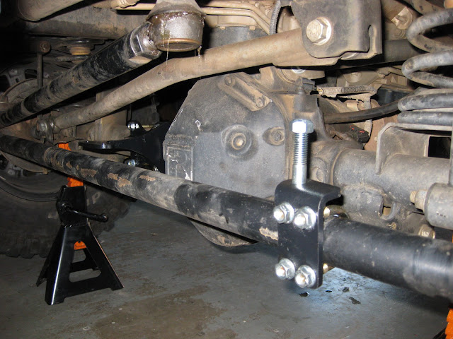

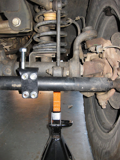

Cool, easy enough. Used the supplied U-bolts and made them snug, knowing that I will have to fine-tune its position a little later...

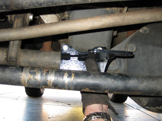

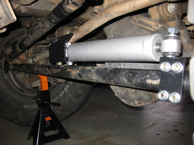

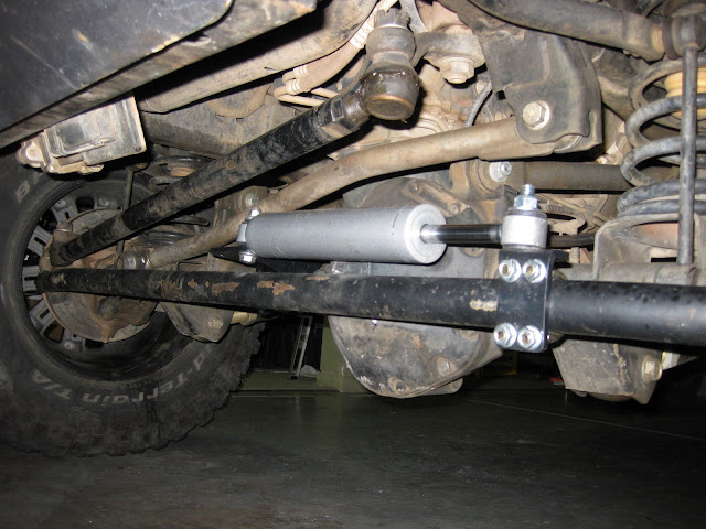

Now on to the tie rod bracket. The instructions give specific placement. Something like 6" away from the adjustment bolts on the OEM tie rod. Well, I dont have the OEM tie rod, and I also moved the axle bracket over. So, I take a guess and put it on, only snug, knowing I will have to adjust it in a little bit. Oh yeah, you have to put on the 1/2" x 2 1/2" bolt that the SS mounts to BEFORE you put the bracket on the TR.
So far, piece of cake, I have both of my brackets mounted up...

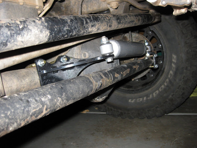

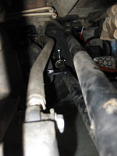

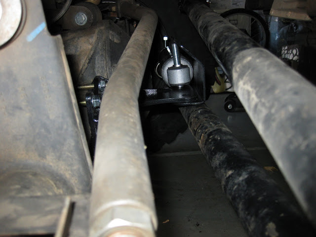

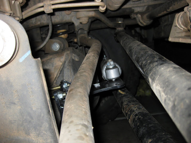

I'm still eye-balling everything hoping that it fits into the narrow lane between the rods. Here is a pic looking toward the psgr side...
And a pic looking toward the drvr side...

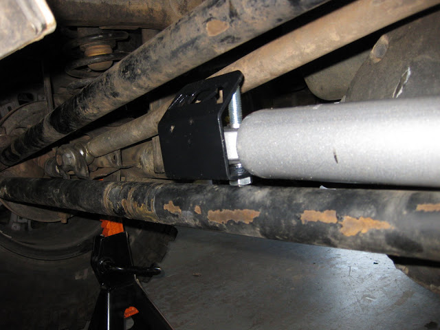

So they supply you with this pretty little bracket with their name on it. Near as I can tell it is only advertising for them, but it does hide the bolts, and makes it look a little cleaner.
You have to run the 1/2 x 2 1/2" bolt through one hole of the "ad bracket" though the axle bracket and then through the end of the SS. Put on a washer, and a nut and good to go. Now remember, they left this bolt out, and I found a 3" long one to use in its place. Looks like it will fit, as it is still under the bend of the "cool ad-bracket."
Hmm, looks a little too tall in there?

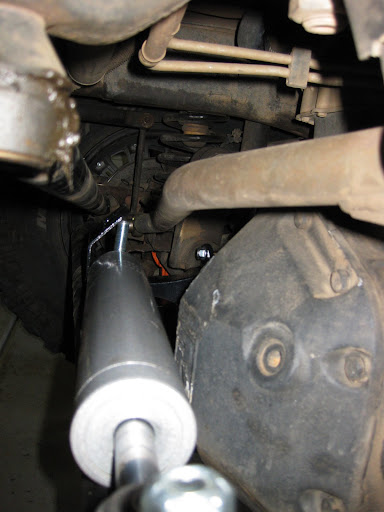

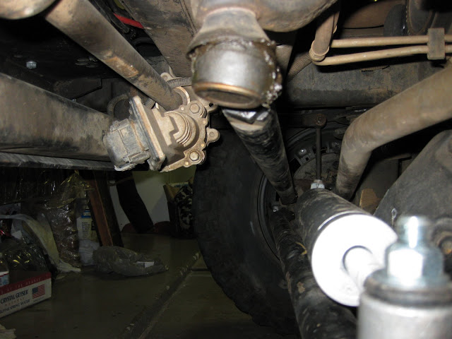

I better cycle the steering and see if it clears. Full turn to the psgr side, no worries...
Full turn to the driver side. Umm, Houston, we have a problem...
So my first thought is to just smash the crap out of the top of that bracket instead of that pretty 45* angle with their logo on it. Then I realized using that damn 3" replacement bolt of mine wouldnt let me smash the "ad-bracket" down far enough. So... now I have to dis-assemble to change that bolt out. I reused a bolt from the TR bracket mount where my old SS was. I might as well not jack with that bracket, and take it out while I take out the longer bolt too... Thats just what I did.

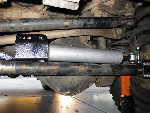

I cycled the steering lock to lock and fine tuned the placement of the TR bracket, making sure it didnt fully compress as I turned to the psgr, and also had enough travel turned full drvr. Tightened that puppy down. Then I rolled the TR all the way up (you know how that can roll on the ball joints...) and made sure that it did not hit the bolts of the axle bracket. Rotated it to give me just barely enough clearance, and tightened that puppy down too.
So there ya have it. The thing rides like a champ. ZERO bump steer. Nice and tight through turns. Wheel still goes back to center after a turn... The diameter of the RC 2.2 shock is much larger than any of the FOUR aftermarket SS shocks I have used in the past.
Good stuff. I highly recommend it. I do need to make sure I dont have any clearance issues when articulating, but it looks good. With a stock setup, I wouldnt worry about it at all.
