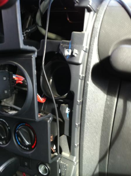

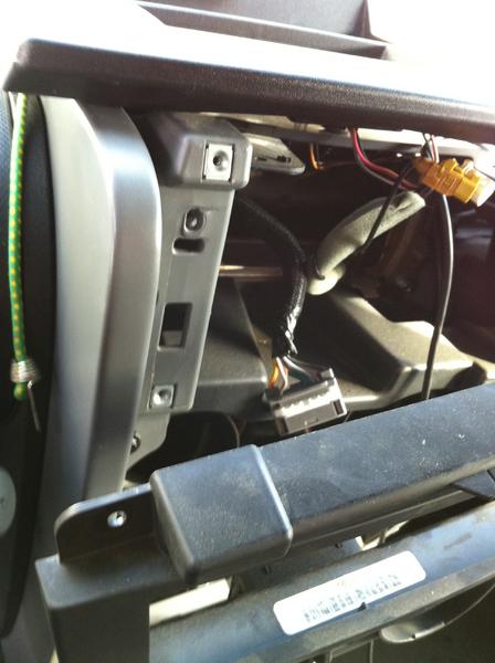

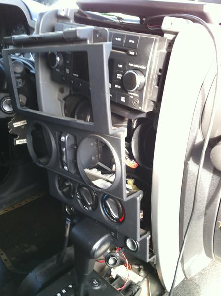

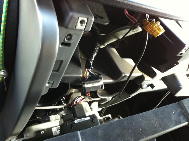

Hey guys, I'm planning on painting the sides of the center stack, the speaker grills in the soundbar, and the subwoofer grill. I'm ordering 12 oz bottles of mango tango, and wasn't sure how much to order. Also, is there a writeup somewhere on removing the sides of the center stack?

Heres the best pics i can find. They each have 3 bolts on center stack and require you to remove the stereo first
