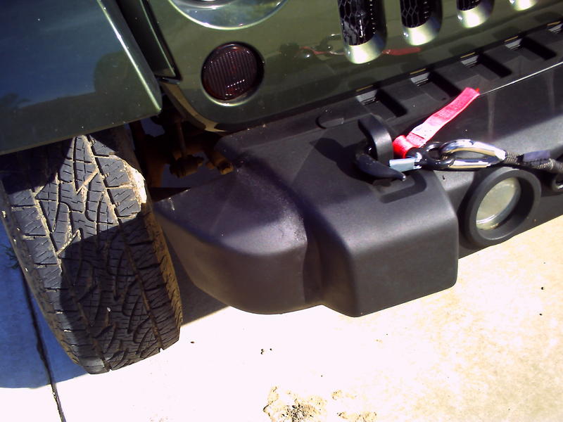

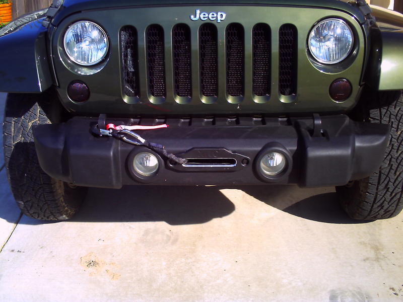

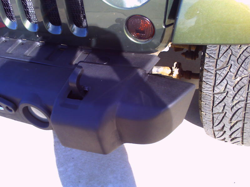

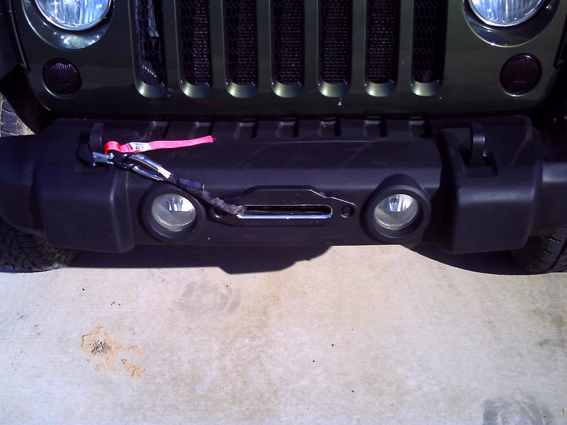

Thanks gpwpat for the bumper!
ID:	146175Click image for larger version
ID:	146176Click image for larger version
ID:	146177Click image for larger version

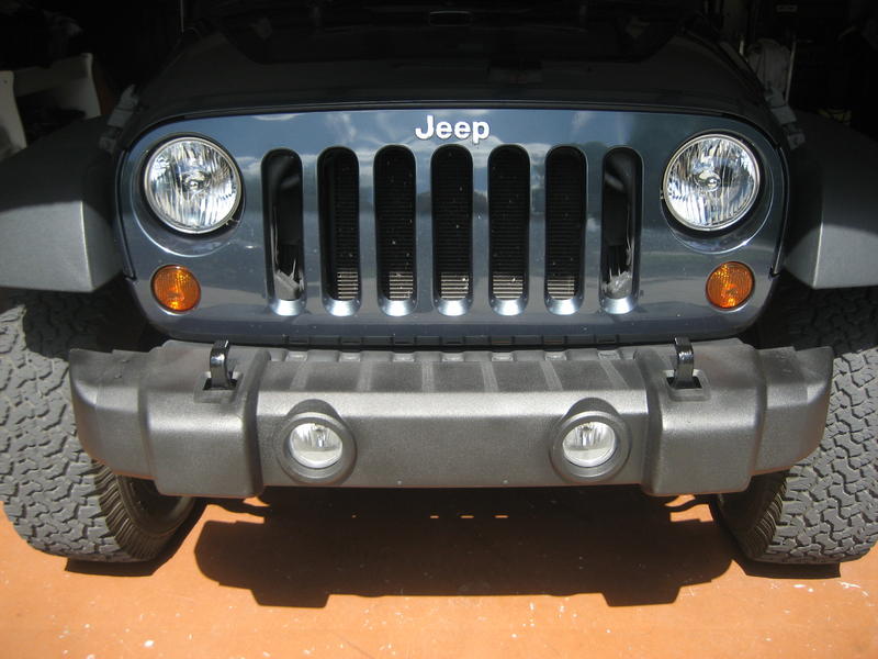

It's unfinished but I wanted a little more of a stubby instead of the little caps
ID:	146192   Click image for larger version

Jhen...
How did you bond then end caps back to the bumper? And which winch do you have. I'm obsessed with your bumper.
Old Apr 6, 2011 | 10:52 PM
  #120
Jhen's Avatar
Posts: 274
From: Sacramento, Ca
Originally Posted by JKU09
Jhen...
I used a 60 min epoxy and a 2 part epoxy putty, both made by loctite. I bought them at lowes. I used a ratcheting strap as a clamp to keep the ends tight until they set up. then used the putty to fill the seams. sand and paint. The winch is a Smitty 8000 w/ synthetic cable.
