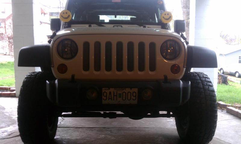

Got mine finished today, looks pretty good I think, I went as stubby as possible

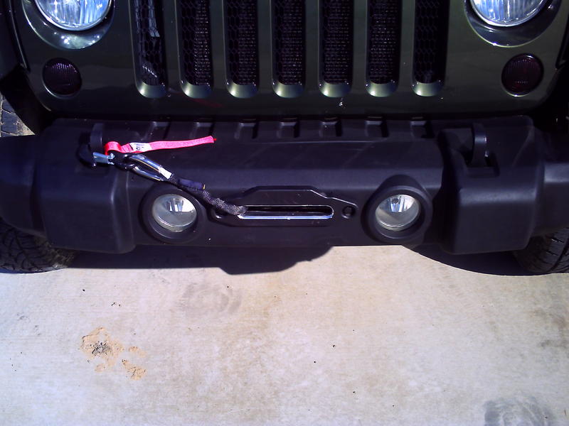

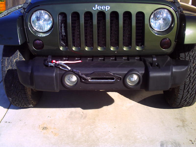

Originally Posted by Running Man
I'm also interested in any pictures someone may have of a stock stubby and a winch mounted! Anyone?
ID:	155704Click image for larger version
ID:	155705Click image for larger version
https://www.jk-forum.com/forums/show...factory-bumper
