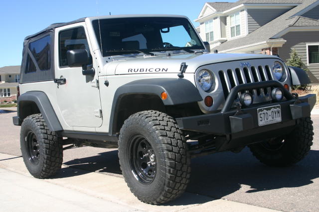

Tera 2.5 BB with 33's.. I like it. Mine went smooth also.. nice write up WayofLife.
