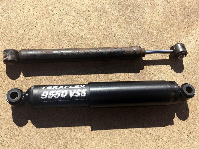

Though I didn’t realize it at the time, I suppose it all started last spring — that’s when I first noticed Smokey jerking hard to one side whenever I drove over a substantial bump at speed. Since I travel the same roads going to and from work each day, I attributed the problem to poor workmanship during recent roadwork. Then I noticed the oil on the floor of the garage.
Looking under the Jeep, I was relieved to see to the source wasn’t the engine, but a blown seal on Smokey’s steering stabilizer. A little research and a few clicks sent a suitable Teraflex replacement on its way.
While the installation wasn’t quite the cake walk the company’s installation video suggested, it nonetheless was simple enough for a novice wrencher like me.

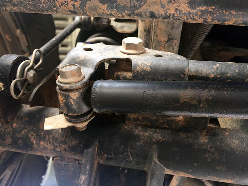

Using an 18 mm box wrench, remove the track-bar-side bolt and tie-rod-side nut holding on the Mopar stabilizer shock. Retain the 18 mm nuts for use with the Teraflex unit. A quick inspection of the removed shock confirmed its obsolescence. A single finger could easily collapse and expand the leaky shock.

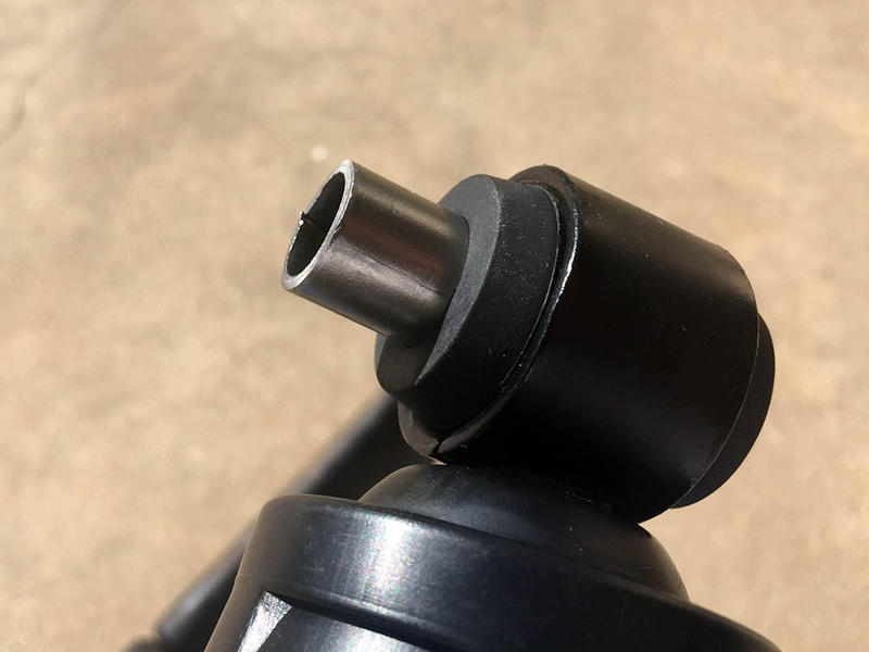

Remove the new stabilizer shock and hardware package from the box. Push the included sleeves into the bushings on the shock. Then, slip the Teraflex shock tube between the mounting tabs on the vehicle’s right side. (It might be necessary to pry open the tabs to fit the bushing between the tabs.) Replace the bolt and slip the shaft-side bushing onto the tie-rod-side stud. Before replacing and tightening mounting bolts, rotate the tie rod through its full range of motion to ensure the stabilizer shock does not come into contact with the bottom of the track bar bracket or that the tie rod bracket does not need to be notched for clearance.

In Smokey’s case, the larger-diameter Teraflex shock had substantial clearance issues which prevented installing the shaft mount on its stud without modification. To address the issue, loosen the four U-bolt nuts using a 13 mm box wrench. Next, rotate the stud downward until adequate clearance is achieved.
At this point, have a friend start the Jeep and slowly turn the steering from lock to lock in order to check the expansion and compression of the shock. If the shock is moving too far in either direction, move the stud mount toward or away from the shock body as necessary. I had to pull Smokey’s stud mount just under a half-inch toward the shock to keep it from over-extending.

With all clearance issues resolved, replace and tighten the 18 mm nuts and bolt. The Jeep torque specification is 50 ft-lbs. More important than that figure, however is that the nuts compress the bushing so they come into contact with the metal sleeves. Here is where an otherwise impressive Teraflex product loses a bit of it’s shine: The sleeves provided with the shock are about an eighth of an inch shorter than the original equipment sleeves, making it all but impossible to properly compress the bushings. I read on a couple of forums where individuals removed and reused their factory sleeves. I tried, but was unable to remove mine and, instead, cranked the bolts to about 65 or 70 ft-lbs in order to eliminate unwanted looseness during steering.

Thanks for the write-up. Although a few years old, I just replaced a shot Rancho RS5000 Stabilizer with this Teraflex unit. Removal of the Rancho shock revealed not only a bad shock, but the bushing housing that connects to the tie-rod bracket was cracked straight through. When trying to install the Teraflex stabilizer, it was evident that the tie-rod bracket had been bent, so as to not allow the sleeve/bushing to go through the pin. However this got bent is likely what broke the Rancho one. Luckily, I was able to take the bracket off, straighten out using a vise and some heavy duty channel lock pliers and re-installed it.
Mine is also a 2009 and I encountered the same things as you. I also had to move the bracket slightly closer to the passenger side wheel in order to prevent the shock from over-extending. Thanks again
