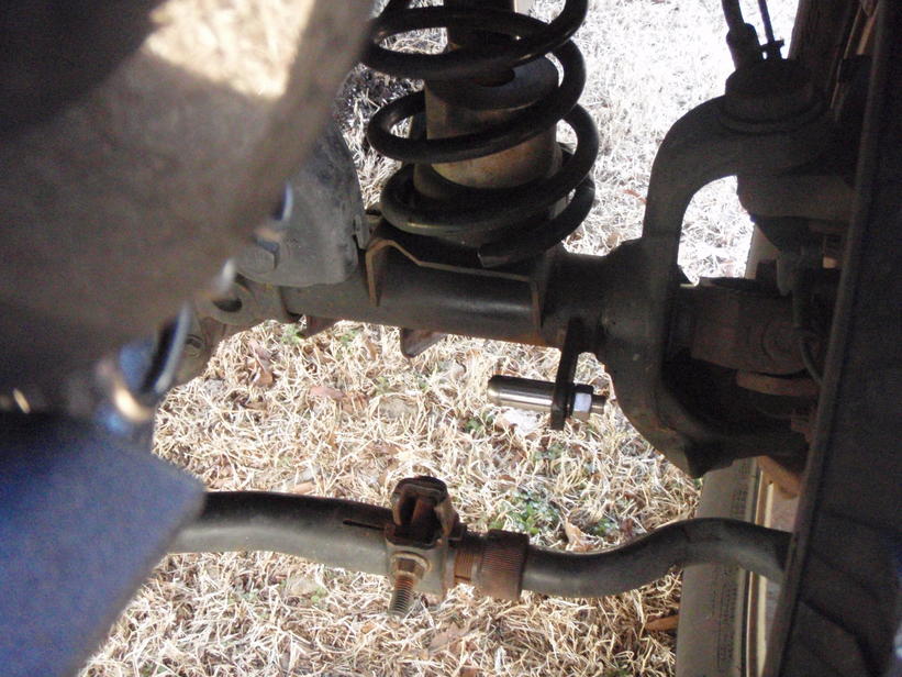

Hrmm, I have a weird issue.
If I use the stock axle mount bolts in the upper position, facing out, they rub against the tire lugs when stuffed & turning. If I turn the bolts around so the head faces outwards, it works fine while disco'd, but then I can't swing the sway bar back down because the threaded end of the bolt hits against the metal 'cowl' of the coil retainer (near the word 'which' in your 5th picture).
Any suggestions? Should I get shorter bolts?

I installed these last week and yesterday I tried to disconnect and then stow
them. I soon discovered that the bolts are slightly too long, maybe a thread
or two. They would move past the spring cowel with a push, but I had to tap
the sway bar with a block of wood and hammer to get the sway bar back
down to driving position. Defintely gonna have to trim a bit of the bolts
to eliminate this minor problem.

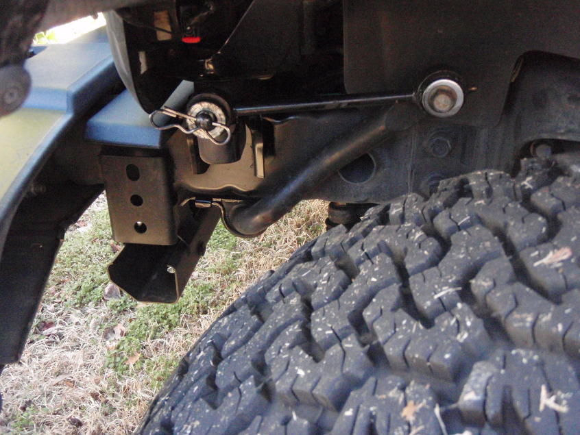

Just got mine yesterday..quick question:
1) is there a top and bottom to the disconnects?(does it matter which end goes to the frame and whice end is the "sway"?)
2) do i only need to remove the silver bushing on the "Sway end" not the one attached to the frame?
3) the pin where i stow the bar in the "disconnected" position isn't a tight fit..it slightly jiggles. is taht correct?

wow, no one answered your questions...
well, i just opened my box and it appears that at least the latest batch of these (so far the 3rd design i've seen for the same disconnects). has 2 totally different size mounts for the bottom quick disconnect and the storage quick disconnect. mine are very different in size. so the bottom ones go into the links without the sleeve, and the storage ones just fit lose, probably to make it easier to throw them up there, there is no need for them to be tight.
so the top link's bushings do have the sleeve, and the bottom ones that connect to the quick disconnects do not have a sleeve, the disconnect is a tight fit without the sleeve, no play. but the storage quick disconnect pins are smaller now and allow much play in the "stored" position.
the sway bar links are angled as well, so the they should be angled inwards going up. so the bottom is closer to the tire then the top.
hope that helps!

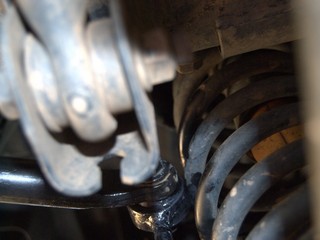

Long background story, but, i've needed to replace my factory sway bar link arms quickly before Christmas, and the teraflex quick disconnects were the only ones I could get before the Christmas shutdown.
After fitting them, i noticed that the right hand side (driver's side for US Jeeps, passenger side for my Australian Jeep) disconnect now touches the suspension coil / spring. Although it is not pressed really hard against the spring, clearly it is not a good setup and the 10kms of driving since fitting it already show rub marks on the disconnect.
Has anyone noticed this problem? The weird part is that the other side has enough clearance between the spring and the disconnet to not be a problem. Looking at the spring that is touching the disconnect, it is not sitting exactly in the middle in relation to the bump stop, so I am thinking it is possible the spring has somehow moved forward and is now in the way.
More to the point, can anyone suggest a way to fix the problem?
my thoughts are:
Not quite sure which one to go for, especially given the holiday season is going to make any purchase difficult to achive quickly.
FWIW, I have the Old Man Emu 2inch lift fitting, and the teraflex quick disconnet is meant to be the 0-3" of lift kit, but, i can not find any details about how long the arm is meant to be for that kit, so, i can not be certain that i haven't some how ended up with the 4-6" lift kit Quick disconnect part.
my thoughts are:
- buy someone's original (unwanted) factory link arms and fit those as they are shorter and don't get in the way of the suspension.
- get the offending spring moved backwards a few mm to get it clear of the new larger and longer disconnectable arm
- buy an aftermarket sway bar with shorter arms that will pull the disconnects away from the suspension springs
- buy some other disconnects that are shorter (or longer) that don't get in the way of the suspension.
