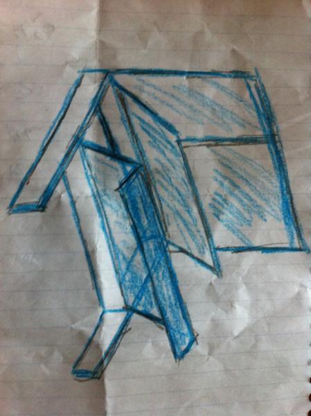

Originally Posted by Crooked1
I'm getting ready to tackle this project too. Thanks for the inspiration ronjenx!!
I do have the Wood's tub enlargement kit and the Tuffy cubby cover. I'm wondering if I can keep the cubby cover to further organize the gear. I may have to leave the backend open to make it work. What do you guys think?
I think you will need to make two door cover with a cross bar in the middle instead of the front so you can open the tuffy cover, sorry for crappy sketch .
I was thinking along the same lines with the cross bar. However, I believe I can still do it with a single cover. If you take the front cover you've drawn and move it to the bottom of the cross bar and lose the flap, it will represent how the tuffy cover will stay in place within the storage area. The cover can still be full length. I think.
I'm also thinking of making it out of 2x6 aluminum tube for a little extra strength and height. If I ever used it as a tent substitute camping, I would want to be certain my 220# plus the wifes 110# wouldn't bend the supports.
