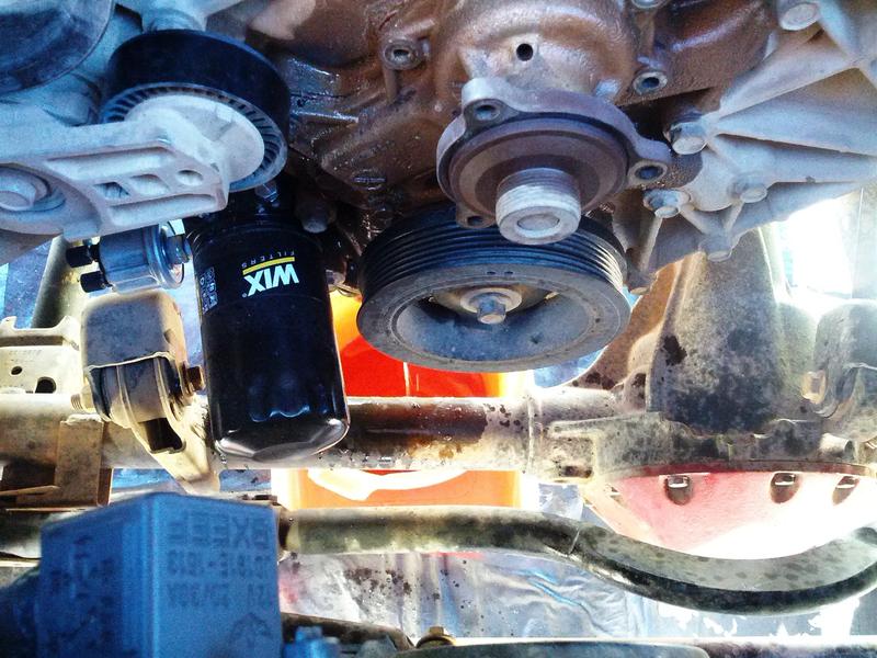

Thanks for the write-up. Very helpful. I do wonder about draining the radiator first. I didn't because I had just spent $140 letting the dealer flush and refill my coolant. If you're going to the trouble to drain the radiator, then seems to me that you should also flush the system (should be done about every 100K miles for early model JKs; 150K miles for '13 models). If you're not going to flush the radiator, then there's no need to fuss with the radiator. Loosen the water pump bolts, the top bolts a turn or two more than the bottom, but leaving the bolts in place. Place a two gallon bucket and maybe a tarp to catch the splashes--pretty much below the pump. Pry the pump loose from the top, tilting it so that it can slowly drain into the bucket. Recommend disposing of this fluid--it will be about 1-2 quarts, and replacing with fresh 50/50 mix.
Name:	Jeep Work, Sep 13, CP_0924, Removing Water Pump.jpg
