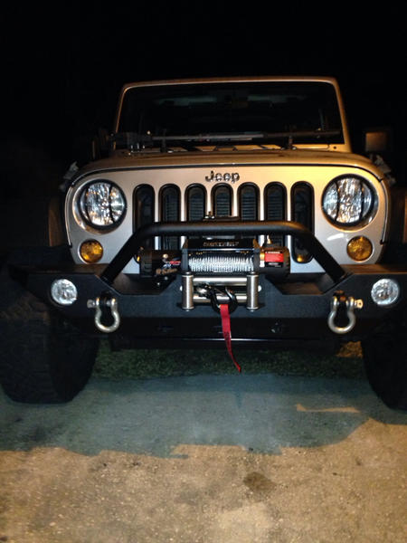

Old Dec 28, 2014 | 07:44 PM
sgt381fl's Avatar
Joined: Nov 2014
Posts: 29
From: the LC, Fl
Old Dec 30, 2014 | 06:35 AM
Rippin'AV's Avatar
Joined: Dec 2014
Posts: 48
From: Napa Valley
Looks great. I just got a JKUR and want to get this same front bumper setup. Happy with it so far?
