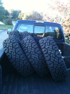

True dat and with those meats in the back of your rig you'll have no issues tackling the trails especially in Fairbanks.
Make sure you talk to the locals, they be the ones with knobs on their tires the size of brick.

I picked those Duratracs because of all the reviews I read from Canucks who loved them on packed snow and ice. I guess all the siping they have does pretty good in that stuff. Getting a set for both trucks but the Jeep is first since her tires are bald
