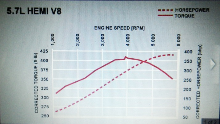

I am making the change to the motor and transmission combination below from the stock 3.8. I am currently running 35's with 5:13 gears. I believe the 5:13 gears will be too much for the Hemi. If the torque curve supplied by Dodge is correct the 5.7 should have enough torque and horsepower at seventy mph to run 35's with 4:10 gears. The 5.7 motor at 1850 rpm produces approximately 335 ft lbs torque @ 280 HP. Does this sound about right? I want to have the gears changed the same time the Hemi is installed but I want enough gear that the motor will not down shift all the time like it was with the 3.8 when going up hills but still have some gas mileage. The stock Ram trucks with the 5.7 come with a 3:55.
Stock Specifications Hemi Specifications Stock Ram
Motor 3.8 - 196 HP - 232 Torque 5.7VVT - 390 HP @ 5600 rpm
407 Torque @ 4000 rpm
Transmission 42RLE 545RFE / 65RFE
1st Gear 2.84 3.0
2nd Gear 1.57 1.67 / Kick down 1.50
3rd Gear 1.0 1.0
4th Gear 0.69 0.75
5th Gear 0.69
Differential Gear 4:10 / Presently 5:13 3:55 on Dodge Rams
Vehicle Weight 3935 4629
Tire size 255/75R17 = 32.3" 265/70R17 = 31.6"
Presently running 35's
