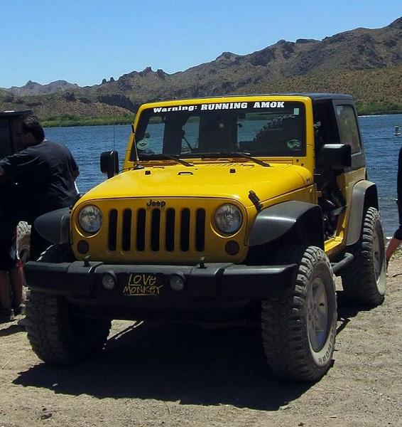

Hey love, what does your rig look like?

What did you wind up doing with your tires / gear setup? I think we have the same rigs. 08 x detonator yellow 2Dr

Wasn't up early...was just getting ready to crash.
I've got 35's & thinking of regearing in the fall to 5.13's...sleeves/gussets same time. Yes, she's an 08 two door.

You plan on going bigger with your tires? If not you might wanna look closer at 4.88s. I have 5.13s and i was a little overgeared. Either way get a tuner. And match the throttle response also. Huge difference in power and torque. I ran 37s for almost a yr. And still had plenty of power. The mileage on the hwy was around 19.5 if i stayed around 60
