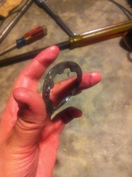

I remove the carrier (again :-() and I discovered why the passenger axle shaft did not want to go in.... The stupid axle guide had turned sideways and was preventing the axle shaft from entering into the diff. Since this is a non-required piece of nylon, I am ditching it

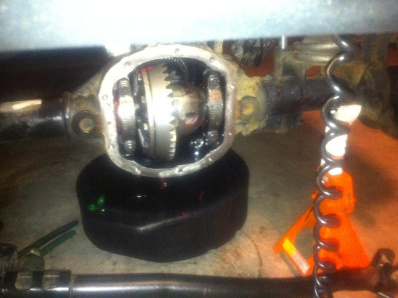

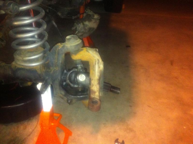

Success!
The carrier is back in, and.... The axle shafts just slide in!
Now to just torque the races back down (again) to 80 ft./lbs.

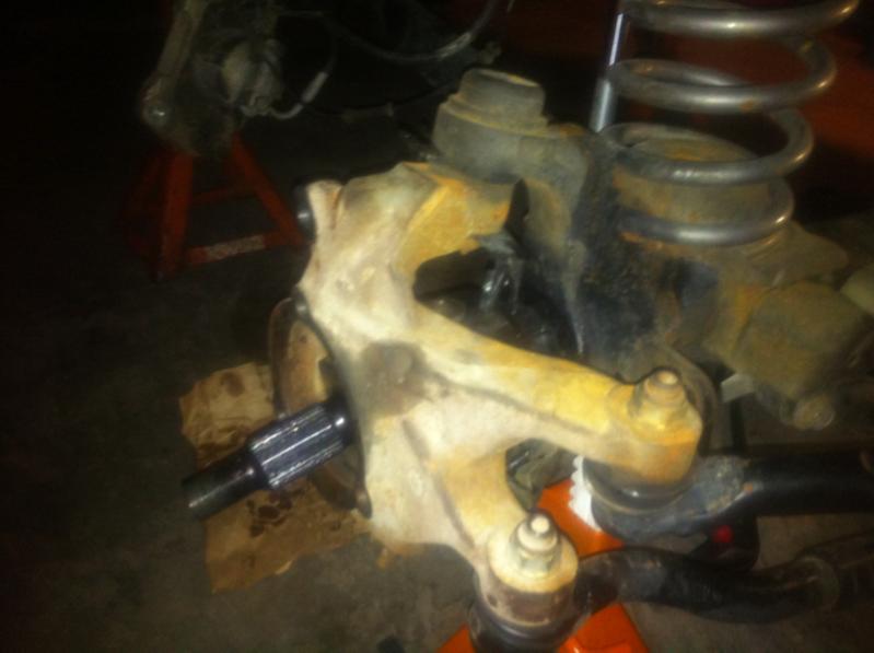

Brake rotors and assembly, check. All torques to spec too
P.S. If anybody is wondering why I'm documenting all of this.... It's because it's 2:30 in the morning, and if I don't talk this through (out load) with at least myself, I am liable to forget a step .

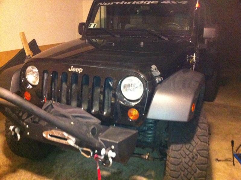

And, I'm calling it a night.
Time for bed!
