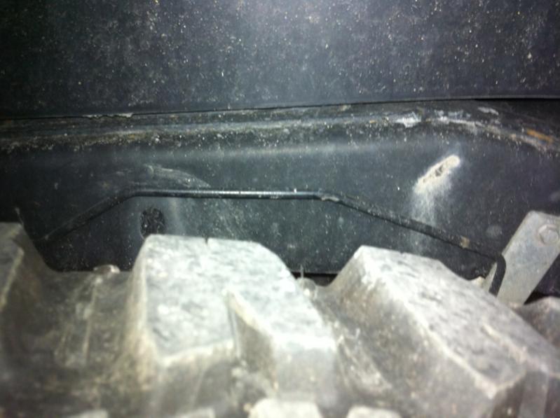

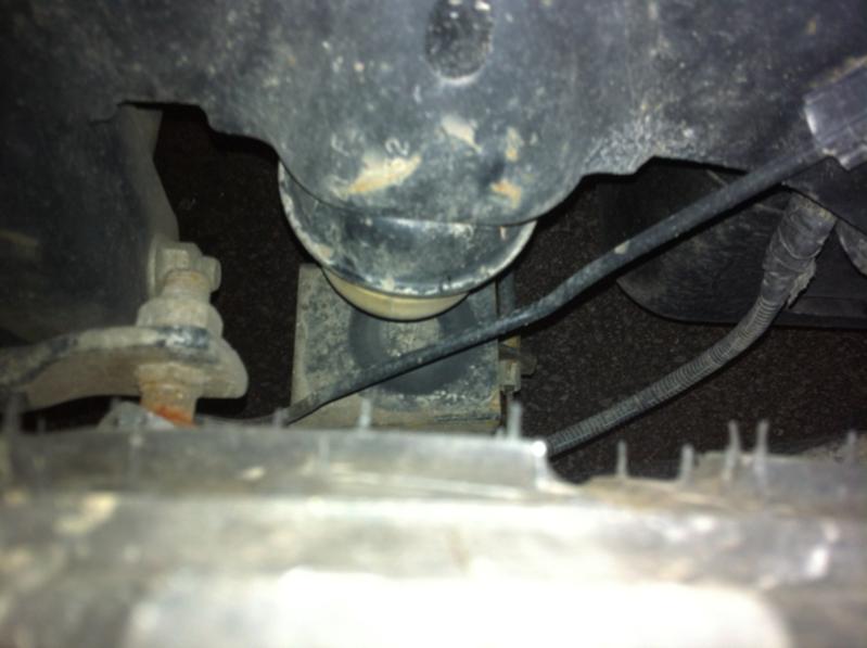

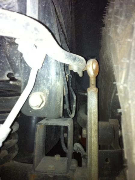

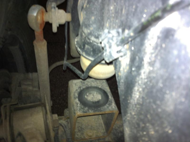

For the second time in 4 months, I noticed that my rear right brake line is totally bent. I noticed the same issue in August, and no one could figure out how on earth it happened. I assumed it must have been from an off roading trip to CO. Now I am back at school, have not done any off roading since the last brake line issue, and I just noticed again that the cable is totally bent. Last time I repaired this it was over $200, so I am pretty pissed this happened again. I have the off road evo lift. Has anyone ever had this issue before?? The first picture is a picture of my unaffected left brake line, and the other pictures show the messed up one. How on earth could this happen with no off roading? Even from off roading, It doesnt seem like anything could catch the line. This seems like a freak thing to me. Any help is greatly appreciated.

The top bolt from your swaybar link is catching the brake line and pulling it down. I've had the same thing happen to me once.
Cut the excess threads off so they are flush with the back surface of the nut. And when you repair your brakeline make sure you route it so it kind of follows the curve of the top the the frame rail and then curves down into the fitting.
