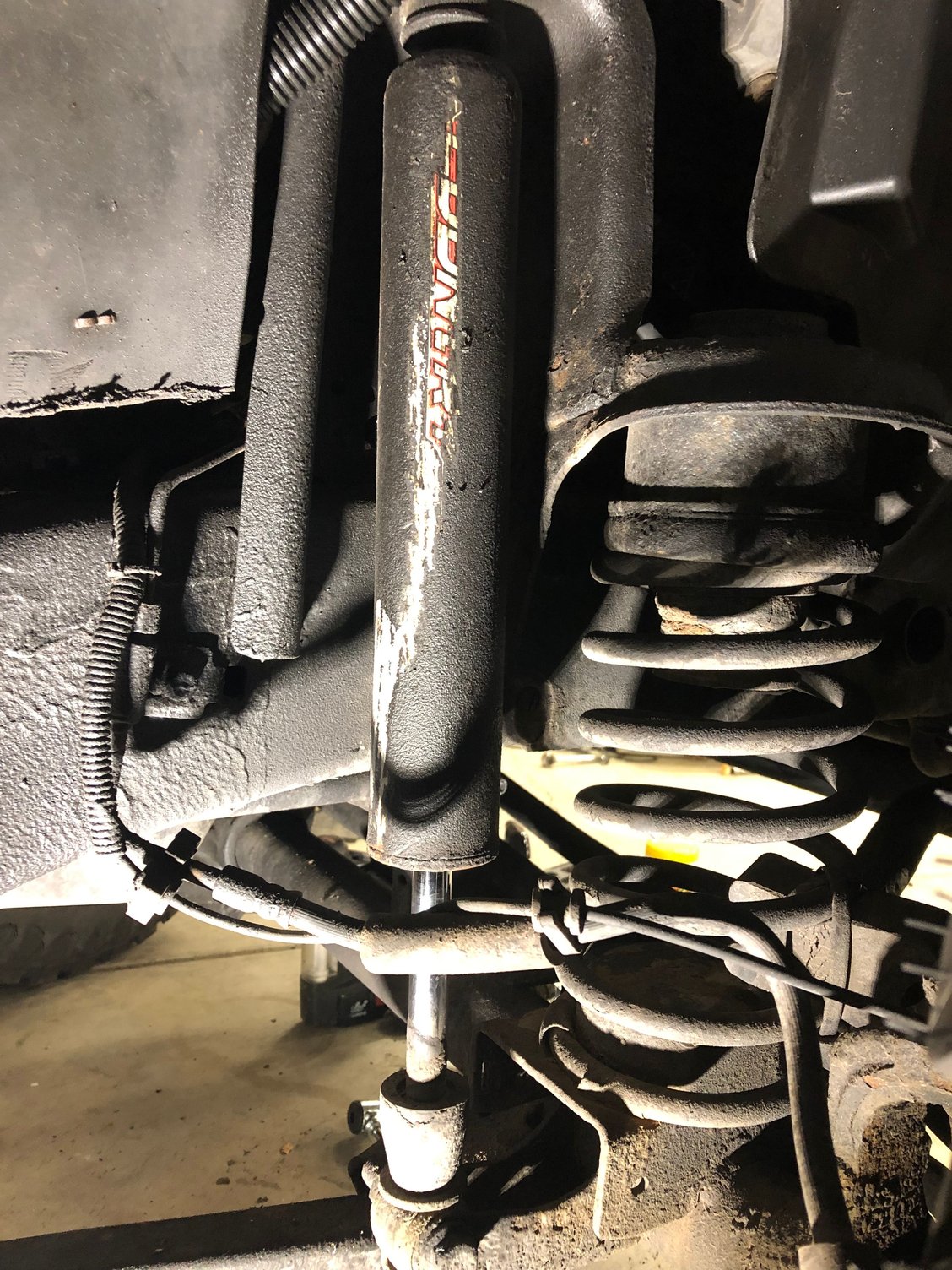

The previous owner of my jk sprayed the undercarriage, including the steering stabilizer and shocks.
My plan (as stated in other threads) is a 3” BDS with Bilstein 5100 shocks
I have the 5100 steering stabilizer, I bought before I just happened to start scraping the old one and learned it was a Rancho rs7000.
I know now people rave about Rancho shocks now. But the 5100 was rated the best for stabilizer purposes. Since I already ordered it, I will swap them out. At least after I can get brake free on the dang bolt. I can’t get it to break loose.
Check the pics out and tell me your thoughts.
Maybe I can get a little cash for the shocks and stabilizer to go toward the new lift 🤷*♂️

And,,, the shocks are Rough Country Performance 2.2 now I am trying to figure out if they installed anything else aftermarket

The shocks are rough country and there is a small piece of rubber spacer zip tied into one of the front shocks.
Thats not a budget boost. Obviously the other one fell out. And that side is one inch lower. Can’t really tell, unless you measure (which I did)
I have 33x12.50s on it now and it looks decent. But I don’t think there’s any other kind of lift on it. That’s why I am looking at the bds

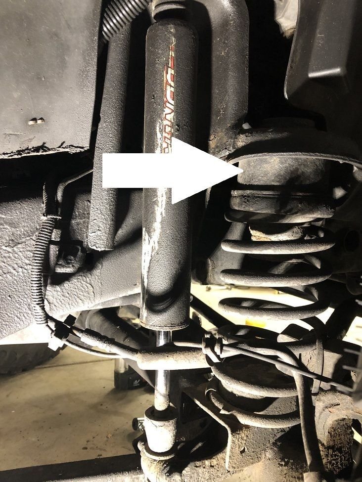

Karl is talking about this right here -

Yep, that's the budget boost. If you're sitting low it's because your factory coils aren't happy with the weight. Budget boosts are nice for a quick lift but the factory coils don't like it. So yes, you need to replace coils. You'll see the same thing with the BDS coils over a short period of time.
Your rubber zip tied onto the coil is a poor solution to keeping the brake and ABS lines out of the coils. Teraflex makes a kit to keep them out of the way but even it is unnecessary.
oh geez!
I am getting old and blind.
Guess it makes sense now.
I guess I can just put some 35s on and call if good then 😬
unless I can get another inch somehow.

Here's your stock measurements -
If you have enough lift to accommodate the tires you want, I'd leave it at that. Performance wise it's fine for pavement and fire trails. If it were me, I'd rather put on some decent adjustable shocks like the rancho xl9000, make sure caster is right, and call it a day. The Bilsteins are good shocks, just stiff. I'd guess that spacer puck is 2.5", which is plenty to run a 35 with proper BS wheel.
