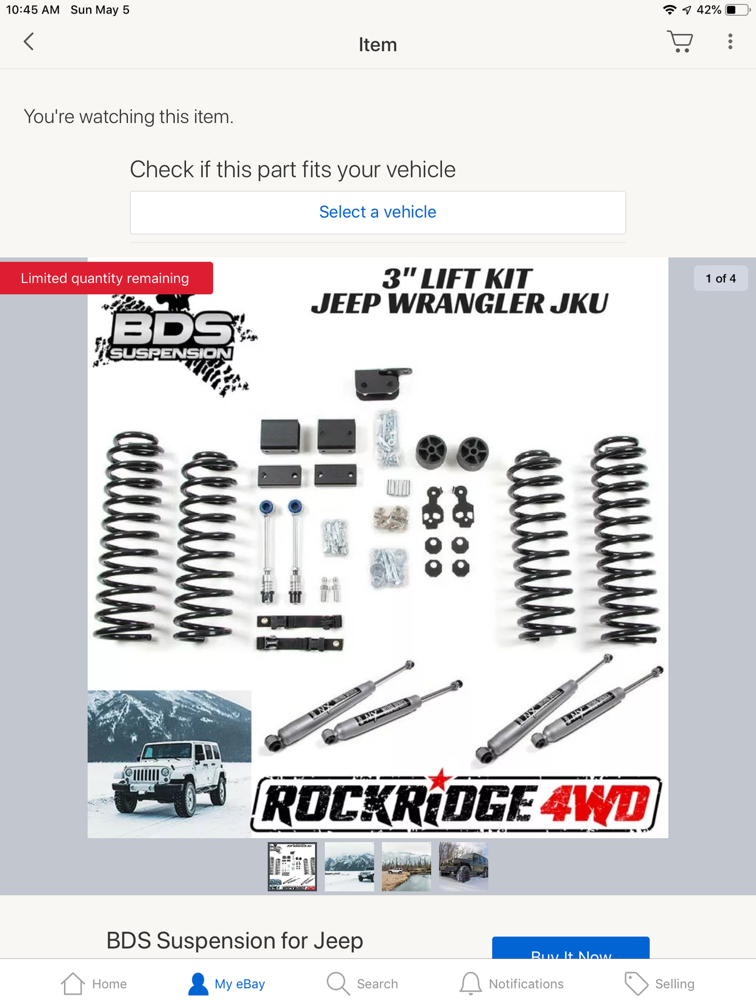

this is the lift I was looking at, but the shocks would be swapped.
I was just talking about my concerns with the rough country that’s on there. I would rather have a new kit installed and know what it is and that it’s not old or been installed incorrectly. It’s probably fine, however, I did find that rubber spacer zip tied in the spring.

Thanks I found that listing, here is the link:
https://www.ebay.com/itm/BDS-Suspens...frcectupt=true
Did you happen to get a price with the Bilstein 5100 shocks included? I'm assuming it will be higher than the $620.86 price.
Here's a few items I'm seeing, others may provide further input.
The NEGATIVES:
- In the rear, sway bar drop brackets are included instead of longer sway bar links to allow the use of a factory wheel and larger tire.
(Actual replacement longer rear sway bar links are a preferred solution, their added statement about "allow the use of factory wheel and larger tires" is made up non-sense. They cut cost by not providing actual rear replacement links and provided a bracket extension solution instead). The majority of the better lifts will provide replacement rear sway bar links. In comparison to the Mopar lift I suggested, the Mopar provides rear replacement SB links, where the stock rears links are longer and get moved to the font and the front factory links get thrown out.
I also noticed the seller includes this statement.
**PLEASE NOTE THIS KIT ALSO INCLUDES BDS FIXED SWAY-BAR LINKS**
So I'm assuming they mean the "rear" sway bar links? If that's the case then they already understand the benefits of using a replacement link over some link extensions.
However this is a lot of confusion since they don't spell out rear and front sway bar links. You need longer rear sway bar links, where the stock factory are long enough to move to the front.
Fixed swaybar links are included for Rubicon models with the factory disconnect system, for non-Rubicon models choose between BDS Ultimate Sway Bar Disconnects or JKS Quicker Disconnects. In the rear, sway bar drop brackets are included instead of longer sway bar links to allow the use of a factory wheel and larger tire.
- To correct the rear axle shift from the lift, a rear frame mounted track bar relocation bracket is included.
There are typically 2 ways to address this problem after lifting. The rear track bar is mounted to a bracket on the frame side, and to the axle on the other side. The intent for this component is to re-center the rear axle (side to side) as well as make the TB more horizontal to the axle. The track bars prevent body roll when making quick/sharp steering maneuvers. So the included bracket extends the length of the track bar to re-center the rear axle and also lowers the Track bar to make it sit in a more horizontal/optimal position. An axle side track bar relocation bracket is a much more preferred solution. The frame side track bar relocation brackets tend to be weaker, as well since they are pushing the TB closer to the axle, they have been known to cause interference between the rear TB and the axle. The axle side relocation track bar brackets serve the same purpose but since they are mounted to the axle instead of an existing bracket like the frame side, the axle relocation brackets can be made to be much stronger, as well as they move the TB upwards further from the axle, thus less chance of TB/Axle interference. The Mopar as well as other higher end lifts typically use an axle side TB relocation bracket. Frame side TB relocation brackets are often used by Rough Country.
- Front Adjustable Track bar
BDS offers many variations of a 3in lift. This one doesn't include that front track bar like the previous one you had shown. Thus, the likely lower cost.
The Neutral Land:
Many companies don't include anything to correct your alignment, but BDS includes octo cam washers for the front lower control arms to fine tune the caster angle.
This kit includes cam bolts for caster correction which is the same as the Mopar kit. They're better than no caster correction but they're also the least preferred way to correct the caster. It's the least expensive solution to correct caster. If you aren't going to do any hard core off roading, cam bolts will work fine. Many don't prefer the cam bolts because you have to modify your axle side control arm mounting brackets and they have been known to come loose over time if you do any type of rock crawling.
Specifically intended for 2007-11 models, this system includes an exhaust extension kit that maximizes allowable wheel travel with the factory front driveshaft.
- This is a total B.S. statement. The 2007-2011 JK's don't need this because the exhaust is not routed under the front drive shaft. In the 2012+ JK's the exhaust is routed under the front drive shaft and this is where these would be needed. So if you have a 2012+, this is a bonus needed item. The Mopar kit solves this problem with a better solution by providing a replacement drive shaft in the 2012+ versions of their kit, but as I stated earlier if you get the Mopar 2007-2011 kit and put it on a 2012+ JK, then you would need these exhaust spacers. It's a way to save a buck since a drive shaft costs $400-$500 and the spacers are a $30 part. It's a relatively inexpensive addition to any kit which doesn't include them but only needed on 2012+ JKs.
The POSITIVE
Brake line relocation brackets are supplied to handle the added wheel travel.
- Relatively inexpensive items as well, but are definitely needed. The 2012+ Mopar kit includes these as well. I purchased them separately for $35.
- or non-Rubicon models choose between BDS Ultimate Sway Bar Disconnects or JKS Quicker Disconnects.
This is really the only real highlight of that lift. It includes front Sway Bar Disconnect links. If you go off road, then disconnecting the front sway bar links can be beneficial. If you are mostly a daily driver, then you're not going to benefit from this highlight feature. A pair of sway bar quick disconnects purchased separately are a $100-$150 add-on item.

Yes, they sent me a message on eBay with a quote $752.86 that includes the 5100s.

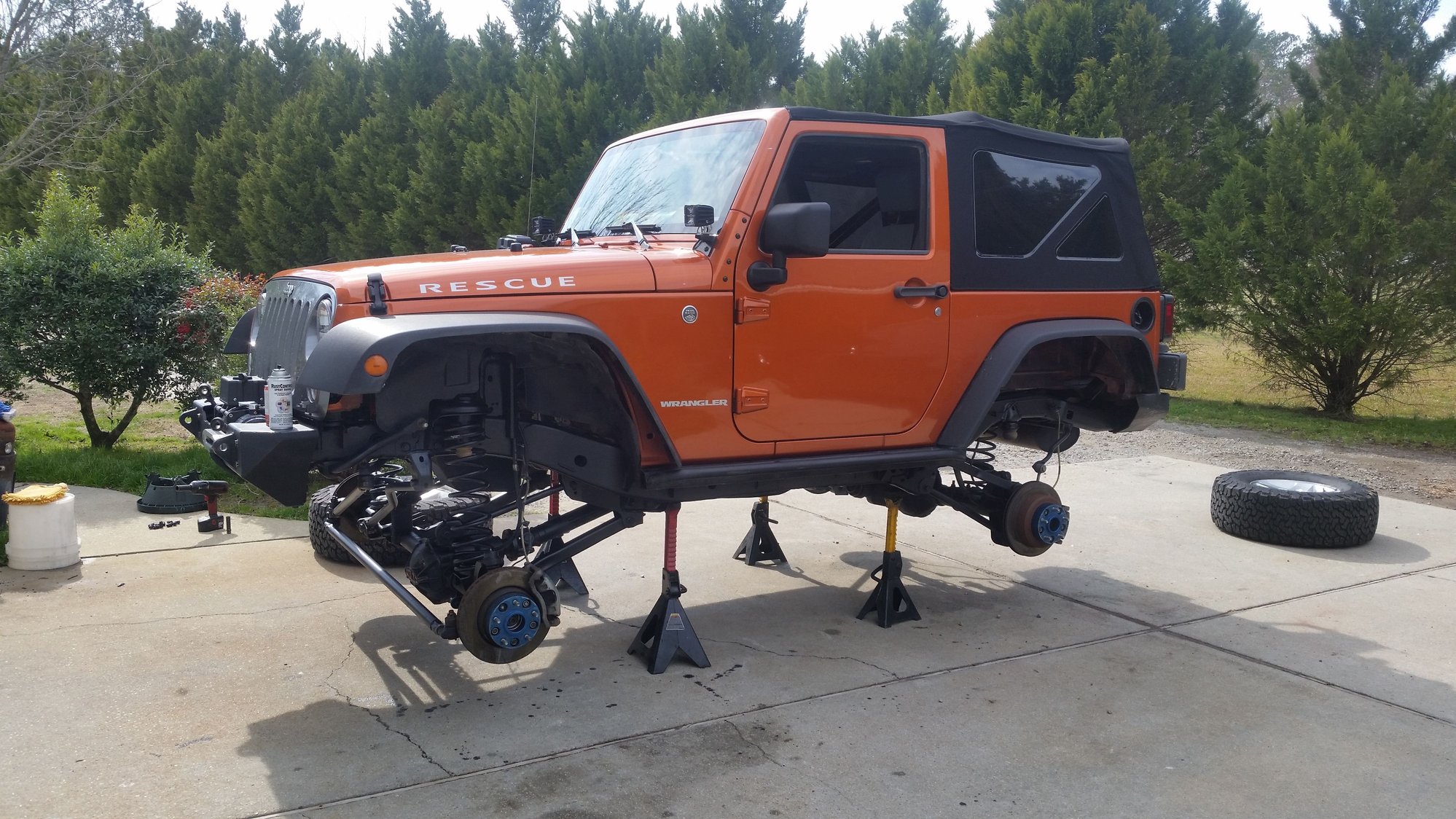

This is my rig with the Mopar 2in lift and 35s, with before/after added weight of an AEV front bumper, front skid plate, 12K winch, rear Hardrock bumper, TF HD tire carrier, and a 35 hanging on the back. I have not rubbed my tires on my fenders yet, the Mopar lift parts haven't rusted and the springs have not sagged. It's a Daily Driver/Weekend Warrior rig where I have no regrets and it's been installed going on 3 years now.
If this is something that interests you, then don't take my word for it. PM me and I will provide you a link to a very long informative conversation from others who have this same lift and can tell you many more details about their experience with this same lift.
