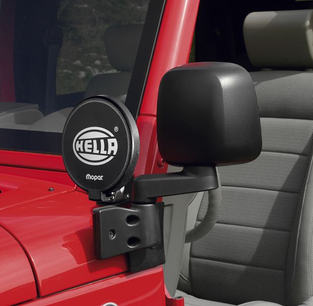

Im actually happy with the mopar doorless mirror kit. easy on and off when changing between doors or doorless. just my .02

i like the mopar bracket as weel and it comes with the mirror so you do not have to remove it from the door.
