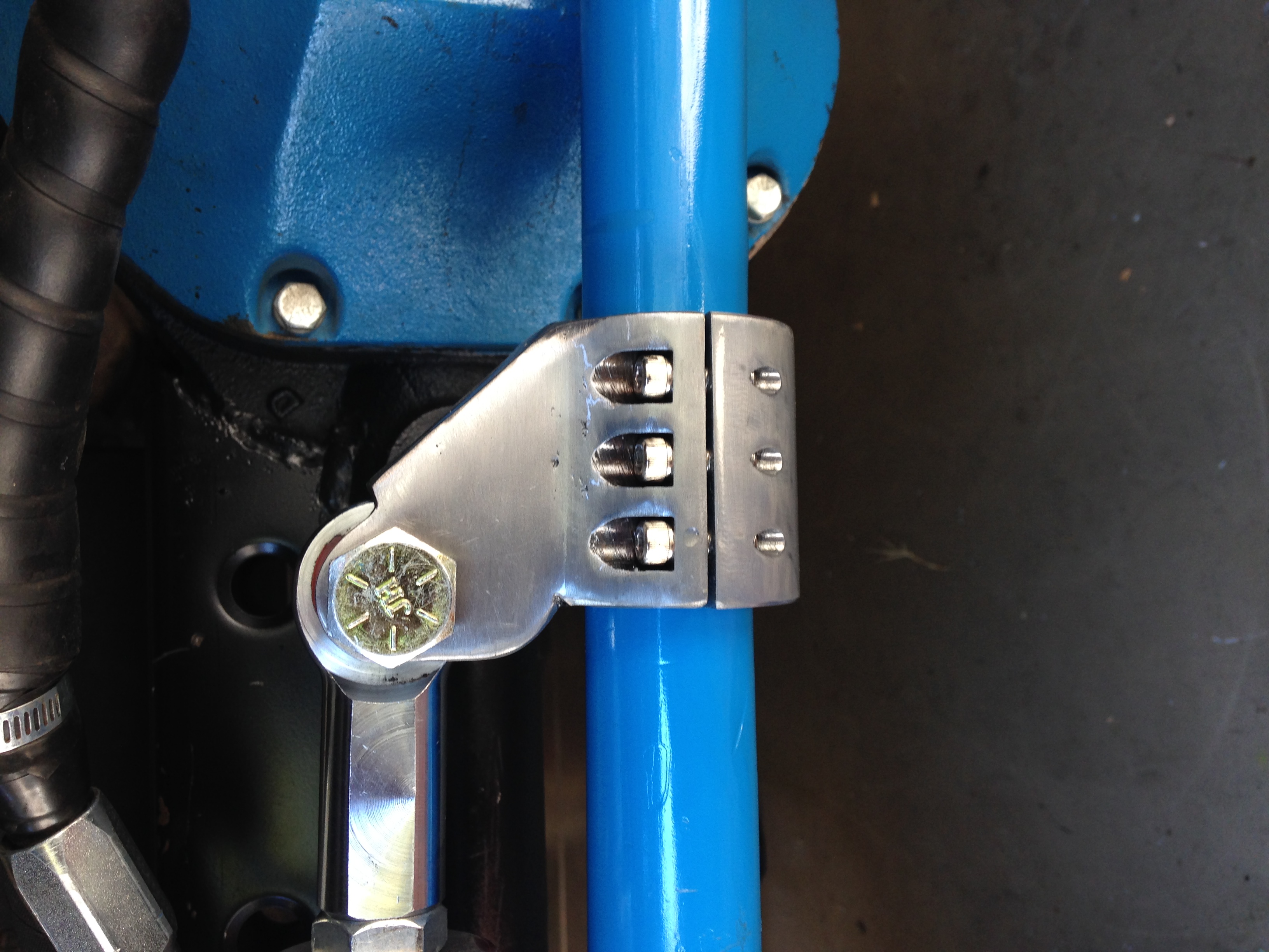

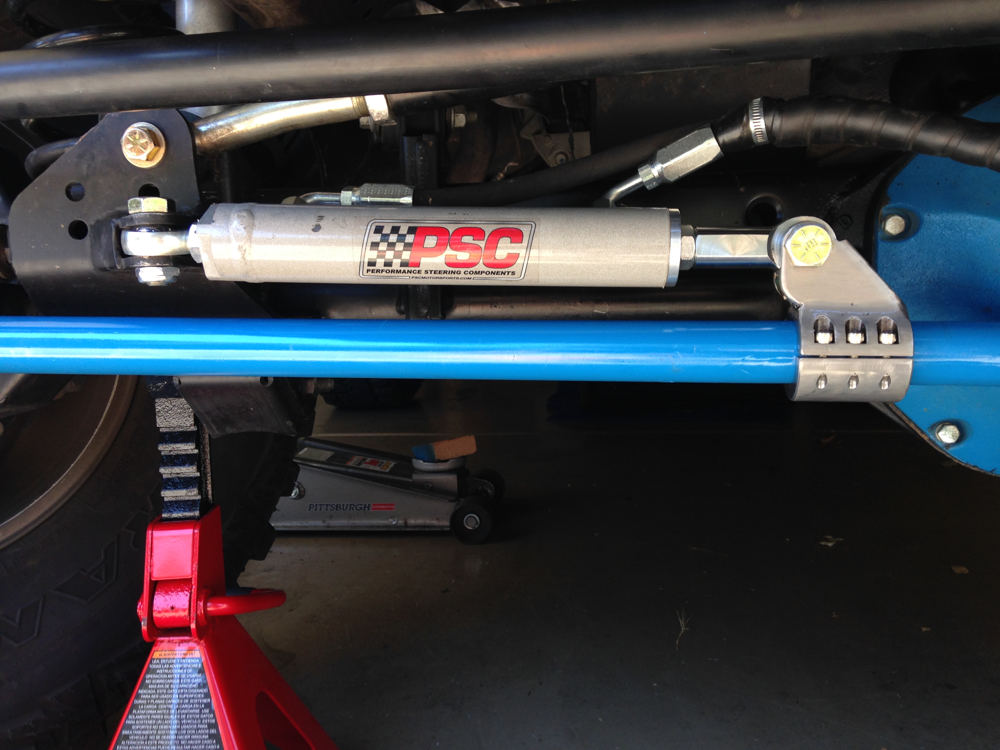

Old May 2, 2016 | 09:44 AM
D_engel's Avatar
Posts: 2,539
From: Tempe AZ
Thats similar to what I used. Sufficient for hydro
ID:	645768Click image for larger version
