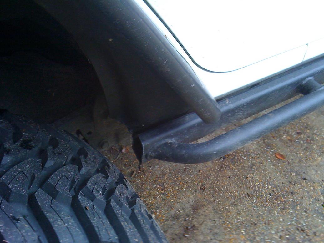

Anyone have a pic of their trimmed rock rails?

I have the enhanced rubi rail

What is everyone using to cut their rails and pinch seams? Very curious, how easy of a job was it for you? Thanks.

I used a sawzall

sawzall, 4" grinder, dremel, hack saw, jig saw... all depends on what is sittin round when the urge hits
