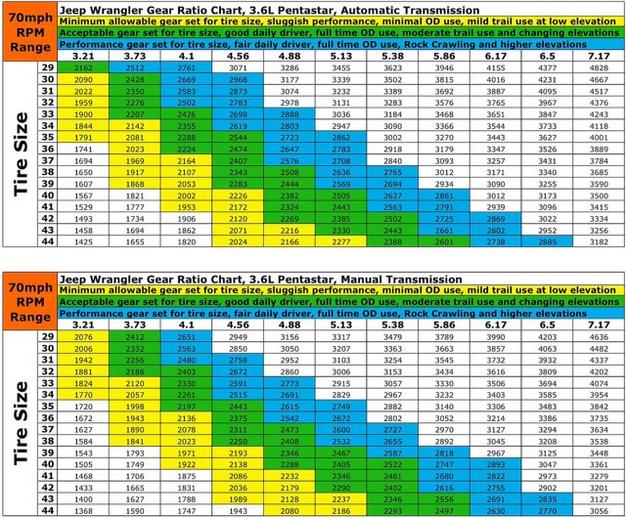

Here is the chart
There is a great website (I have the link at home) that lets you compare before and after changes.
What I have found is that a 2012 on 35 with 4:10's performs almost identical to 3:73 with stock tires. Since I have a rubicon that came with 4:10's I want to maintain the that level of torgue. So, for me I would have to go to 4:56 in order to get back the torgue I lost when I went to 35s. For you it would be 4:88 since you want to go with 37's.
