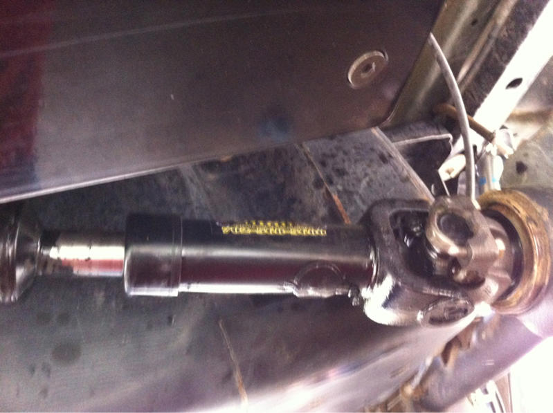

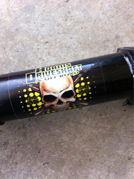

I just replaced front and rear this past weekend with Adams. Shafts are solid and very impressed with the quality. I have friends that run Tom woods and coast and they both agree that Adams was a better route. I say Adams!
