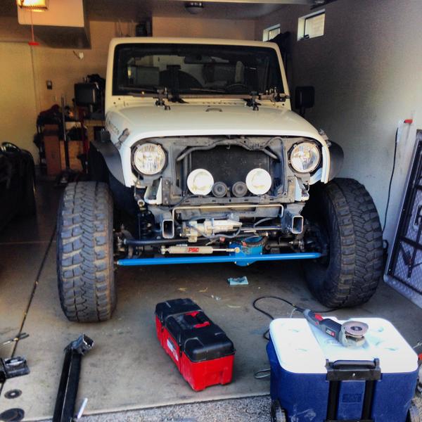

I have a 2014 Rubicon Unlimited and purchased a River Raider Off Road Trail Series front bumper. In order to get it to fit on the shop manager of River Raider told me I need to cut off the cross member which is connected to the frame where the bumper mounts on.
Has anyone done this??? What are your thoughts??
Also any thoughts on how this effects the sway bar disconnect??

It isn't structural. A few high clearance bumpers require cutting that. Tough call man. If it were me (I wheel hard) I'd ditch the Rubi sway bar in a second and cut the crush bar off (crossmember you're referring to).
I don't want junk killing my approach angle. That said, you have the sissy bar and probably want to keep it. In that case, I'd find a different bumper. Or, fabricate your own skid plate.
I cut mine off also to fit Roadmaster tow bar brackets below my Rampage bumper. It was a little disconcerting at first but once I decided to go for it, it came off quite easily with a sawzall. The bumper, bolted to the frame, is much stronger than the crush bar.
