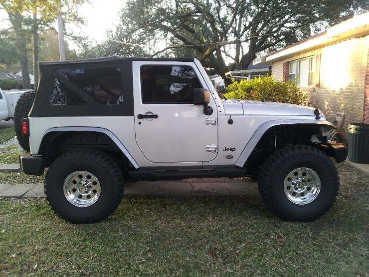

Look up the MB72's from discount tire direct. 15x8 with no rubbing and they come in black or polished aluminium.
