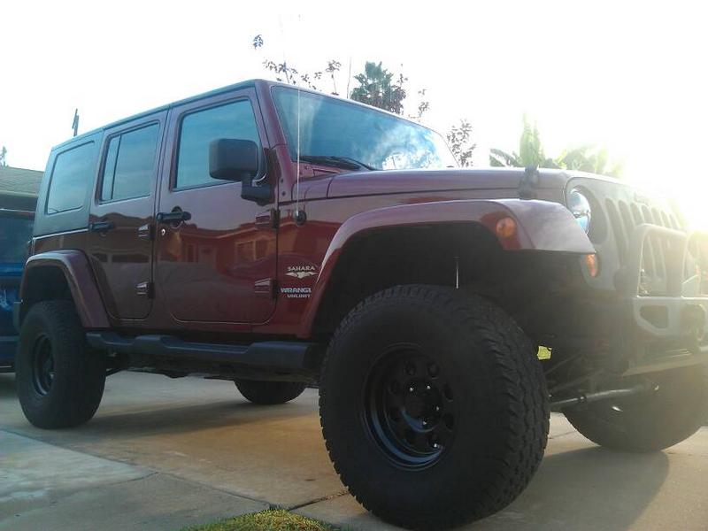

Default 15" mb72
15 " MB72's no problems on my 08 2dr
ID:	398999Click image for larger version
ID:	399000Click image for larger version

Yup mb72 in 15 by 8 fit no prob. Dtd has a whole list of which 15 inch rims fit.
