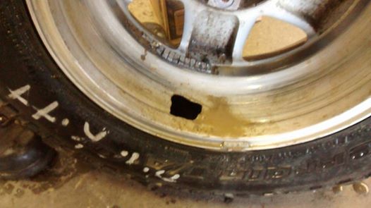

Here's another way of looking at it: One of the guys we wheel with just did this to his 17" wheel
Name:	toms wheel.jpg
A rock got caught in there and punched a hole right through the rim. I don't think there is enough room between the caliper and my 15" wheels to get something that size in there that would do as much damage. In other words, staying with a larger rim size does not necessarily prevent this from happening either.

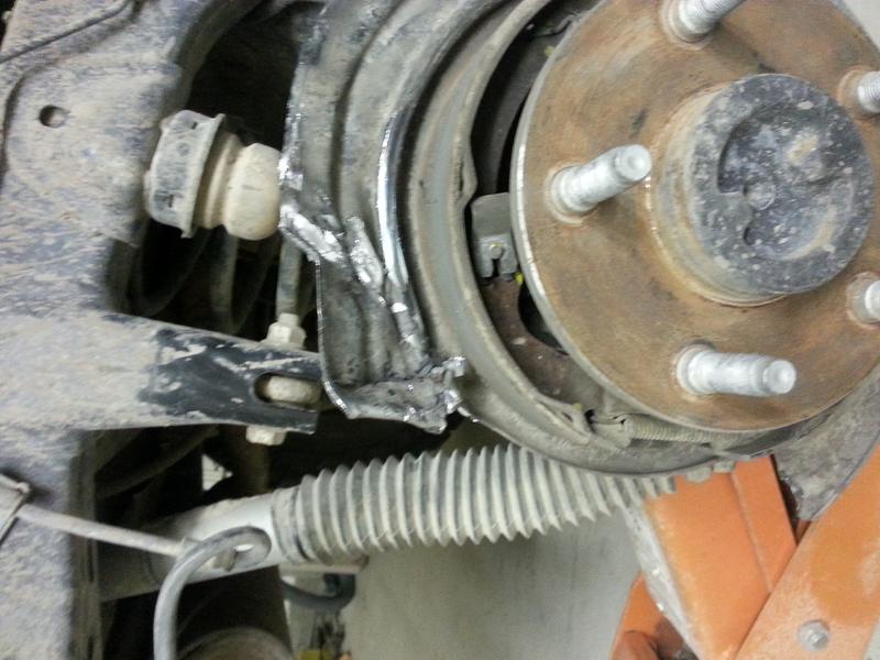

Did that and snapped the caliper clean off leaving on bolt in with the head sheared, but that's why they sell easy outs.
15".
It doesn't matter what ya run, if ya play hard shit happens
