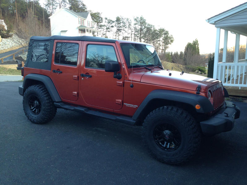

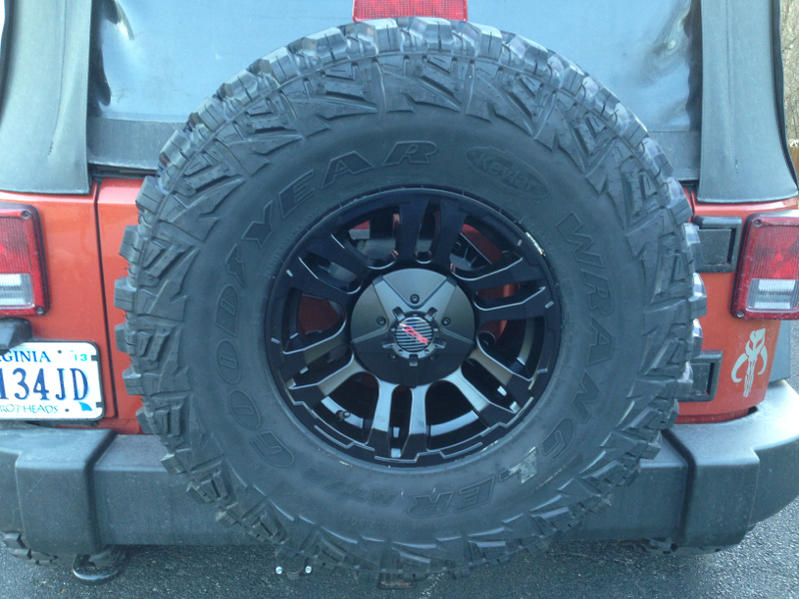

Just put my 15" wheels on tonight. Got 33 12.50 MT/R. Fit great. Wheels are MB TKO.
