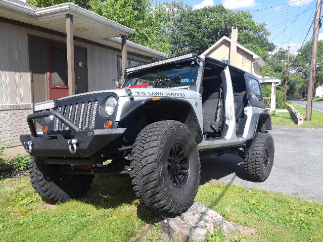

Im running alloy 15x8 mb tko's with same backspacing and 35x12.50 mtr's
