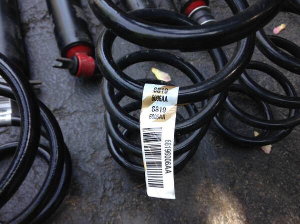

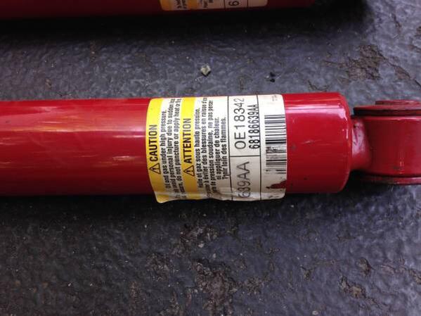

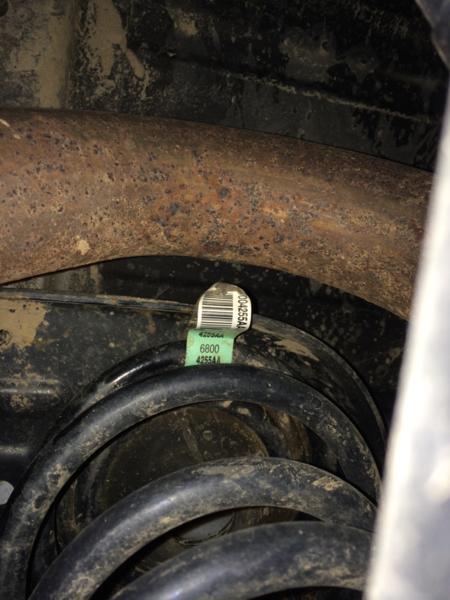

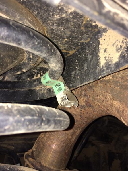

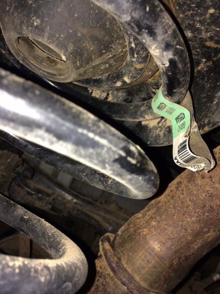

Could not find my springs part numbers. Looking at buying a 4dr 10a rubicons springs and shocks for some cheap lift. Anyone have any idea on if it's worth it? Are the red 10a rubi shocks worth work to upgrade as well(cost is cheap)? I couldn't find my 63 part number for my shocks by its hard to search I apologize in advance if it's right out there. I bought my jeep used and it has these on it. Front: Click image for larger version

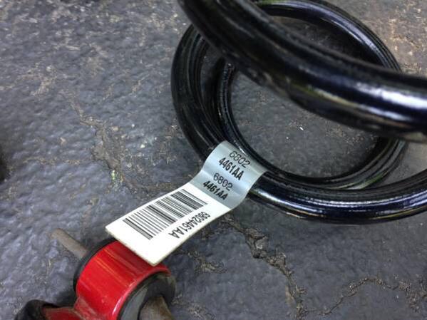

ID:	557661 This guy is selling these: Click image for larger version

shocks are an upgrade over sport shocks and I can tell you that the 10A front coils lift about 1" vs -18 front coils as I have a 2014 Rubicon 4 door and it came with -18 coils up front and the 10A -06's lifted it about an inch.

13's and 54's in those photos so if those are your coils you will get well over an inch probably 2" or so.
