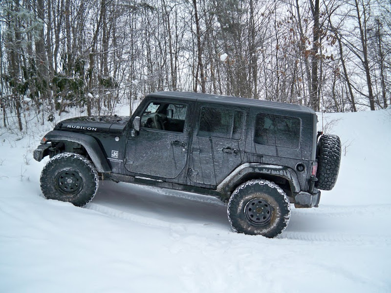

35's on 15" soft 8 w/ a 3" fabtech lift:

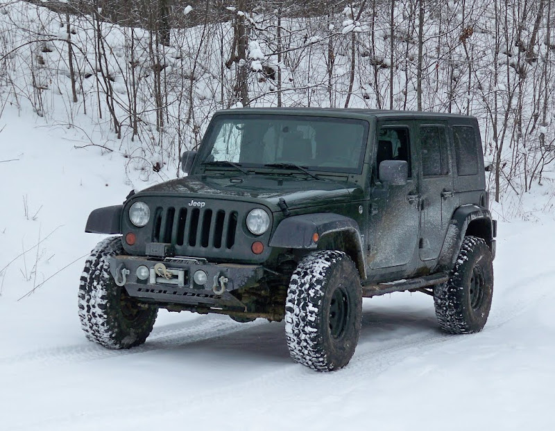

35's on 15" soft 8 w/ a 2.5" teraflex lift:

Did you have to grind your calipers to fit the wheels
Old Jan 11, 2010 | 08:34 PM
Curiosity's Avatar
Joined: Jun 2009
Posts: 552
From: Johnson City, TN
I did just a little on the front. If it scares you to grind em, just put on a wheel w/ a little less backspacing. The soft 8's have 4" bs so they rub on most jk's.
