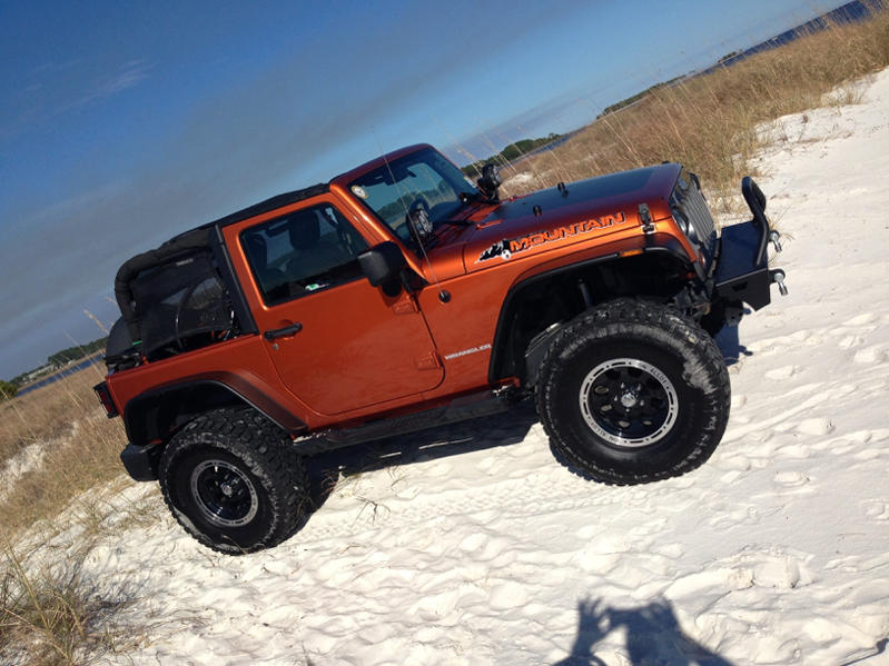

I love my 16 inch rims. No rubbing issues, more sidewall, less money. There are not a lot of options larger than 35 inch tires but there are enough if you choose to go larger.
An older picture, I now I have flat flares.
