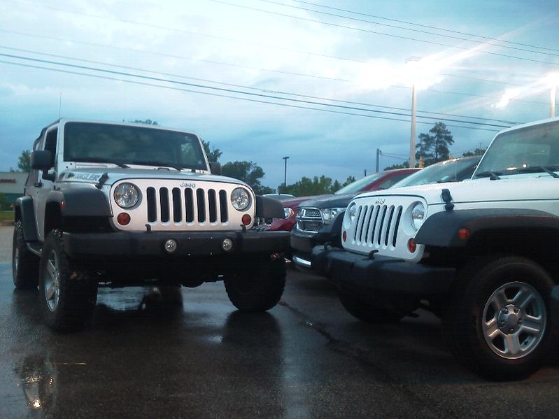

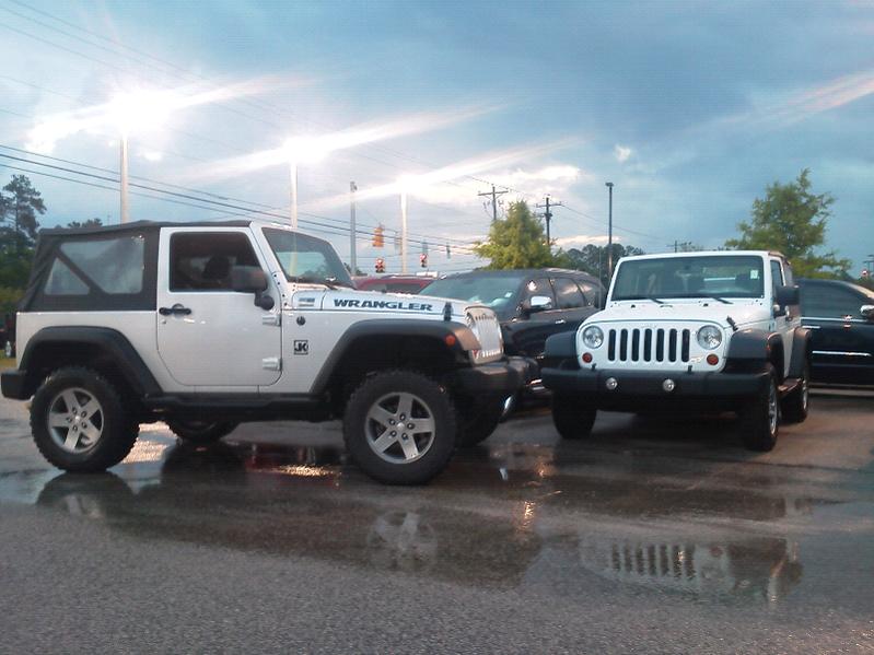

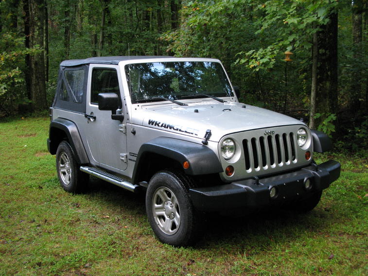

I have 18/59's with TF leveling kit 2" front and 1" in rear. Warn stubby and Engo E9000 winch. I originally had 14/55's.
ID:	520797Click image for larger version
ID:	520798Click image for larger version
ID:	520799Click image for larger version
