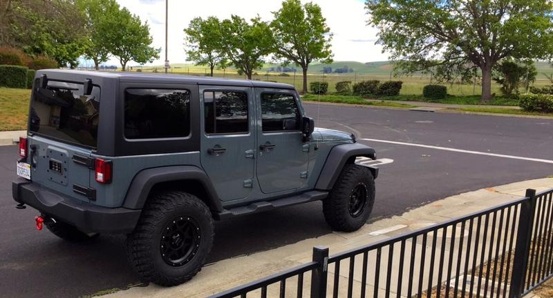

I just installed the Teraflex 2.5" kit on mine with Bilstein 5100's and Goodyear MT/R's. It's the second Teraflex kit I've ran (two separate Jeeps), and I've been happy with both. The installation is simple, it rides nice, and looks great when paired with 35's. I haven't had the chance to get on any serious trails yet with this JK, but I've always been happy with Teraflex.
