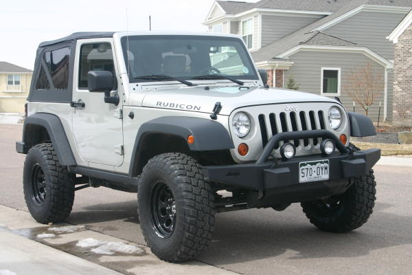

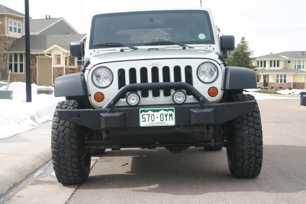

i picked up the bumpers for my wifes Jeep really Cheap.. 100.00 bucks each. They are Mopar made by Thule. Very solid bumpers. i will have to cut off the bull bar for a winch though.. Mopar does make a winch acceptable bumper.. great bumpers for the $. You wanted pics of the front or rear?? sounds like you have the rear.
I'll post some of both on Monday, Mike

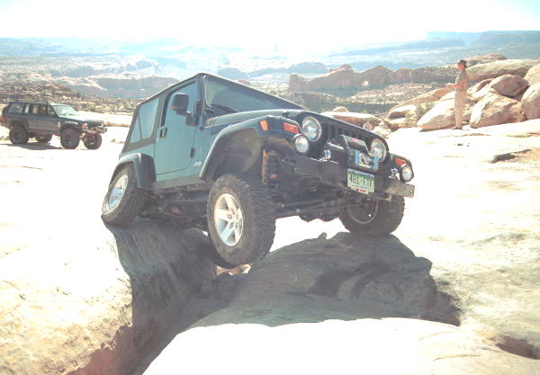

Yup, I'm working on it now and will have it up this week. In the mean time, here's a couple of pics of my JK sitting on the TeraFlex 2.5" BB and stock 32" tires...
Click Here to See All the Anza Borrego South Coyote Canyon Trail Pics

Cajun-JK... i hope you were talking about the attachments of my wifes JK..If not sorry folks.. here it is . the black TJ is mine.
